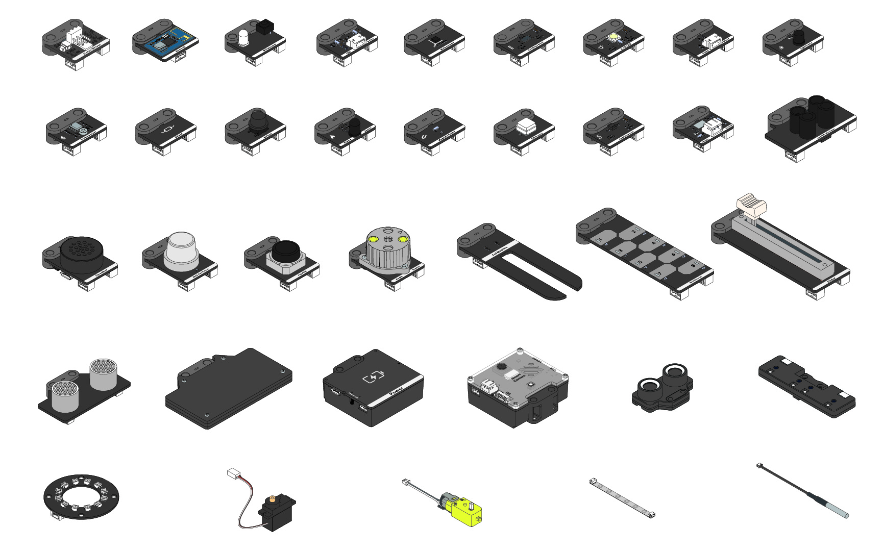

APIs for mBuild Modules
The more than 30 mBuild modules and supporting parts can meet your needs for electronic modules in various scenarios, including making your creative ideas come to life, comprehensive practice, project-based eduction, programming popularization, AI popularization, and robotics competitions.
