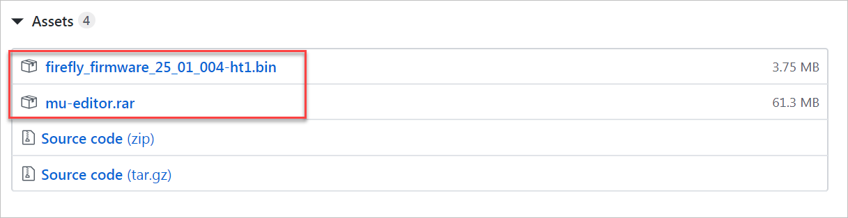

Visit the website below to download the latest version of Mu and firmware of Halocode from GitHub:
https://github.com/FFtust/mu/releases/tag/V0.0.1
Unzip the file mu-editor.rar after downloading.

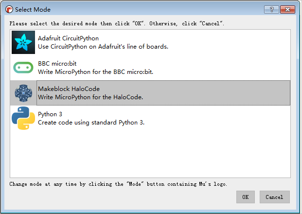

3. Select Mode
From the pop-up Select Mode page, select Makeblock Halocode and click OK.
Note:You can also click Mode to select mode.

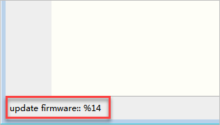

4. Update the Firmware
Before using the Mu editor, you need to use the latest Halocode firmware that we haven't released yet. Click Firmware and select the file firefly_firmware_25_01_004-ht1.bin from the pop-up dialog box. Then you can check the upgrade progress in the lower left corner of the software.

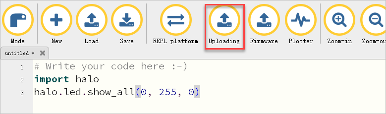

5. Start Programming
Now let's complete a programming task! Try to make the LEDs on the Halocode turn green. Here is the sample code:
import halo
halo.led.show_all(0, 255, 0)
Note:Please refer to Python API Reference to learn more about the function instructions.
6. Upload Your Program to the Halocode
Click Uploading to upload your program to the Halocode, then check if the LEDs turn green?

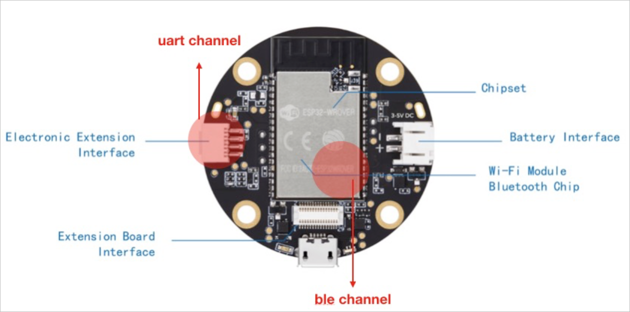

communication
We have developed the serial communication interface of the Ring Board, so that you can use these interfaces with a variety of hardware with serial communication capability (such as Raspberry Pie, some camera modules) .
disable_channel_default(channel)
The Halocode communicates with its electronic module through the hardware serial port. The specific communication protocol is used between the two. If the communication protocol is to be closed, the serial port command of the optical ring board can be “customized”. Please use this instruction.
Parameters: |
channel (str) – “uart1/ble” |
Returns: |
None |
