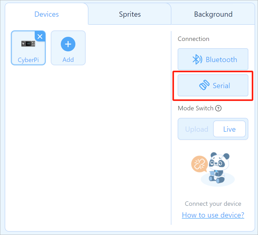

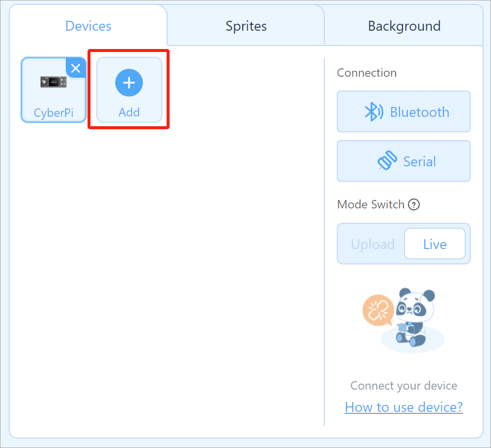

3. Add your device from the device library.
4. Click Serial to connect your device.
5. In the window that appears, select the serial port, and click Connect.

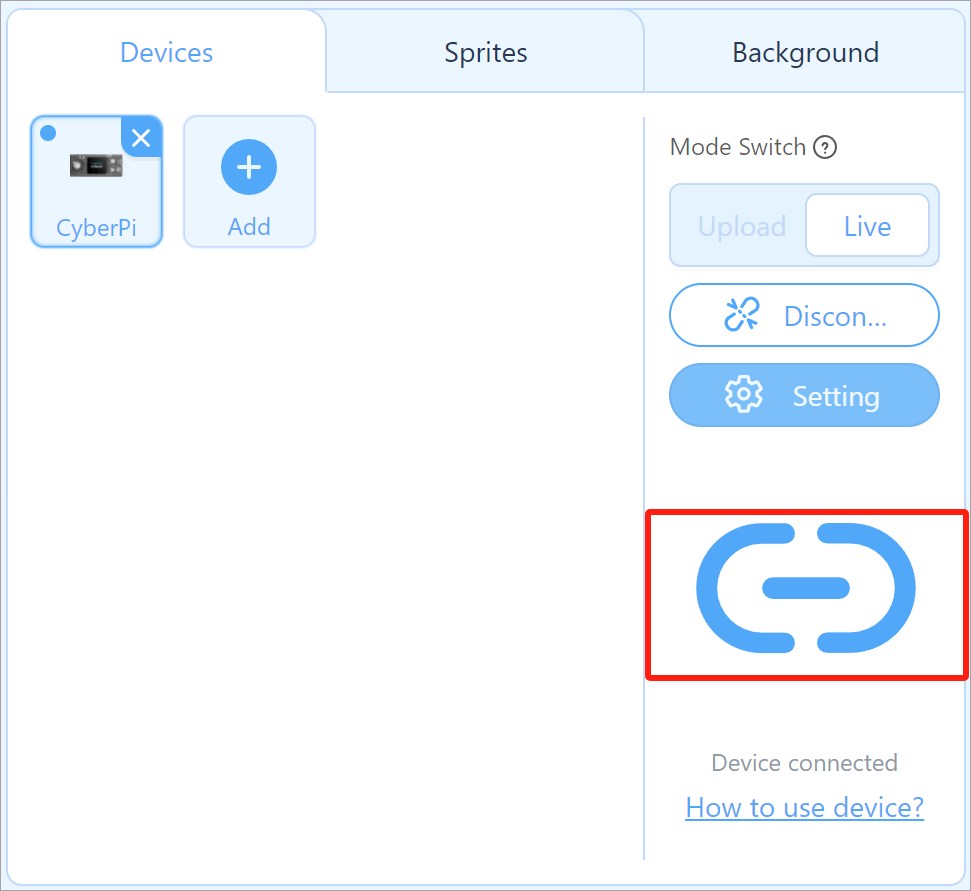

Device connected is displayed after the connection is complete.

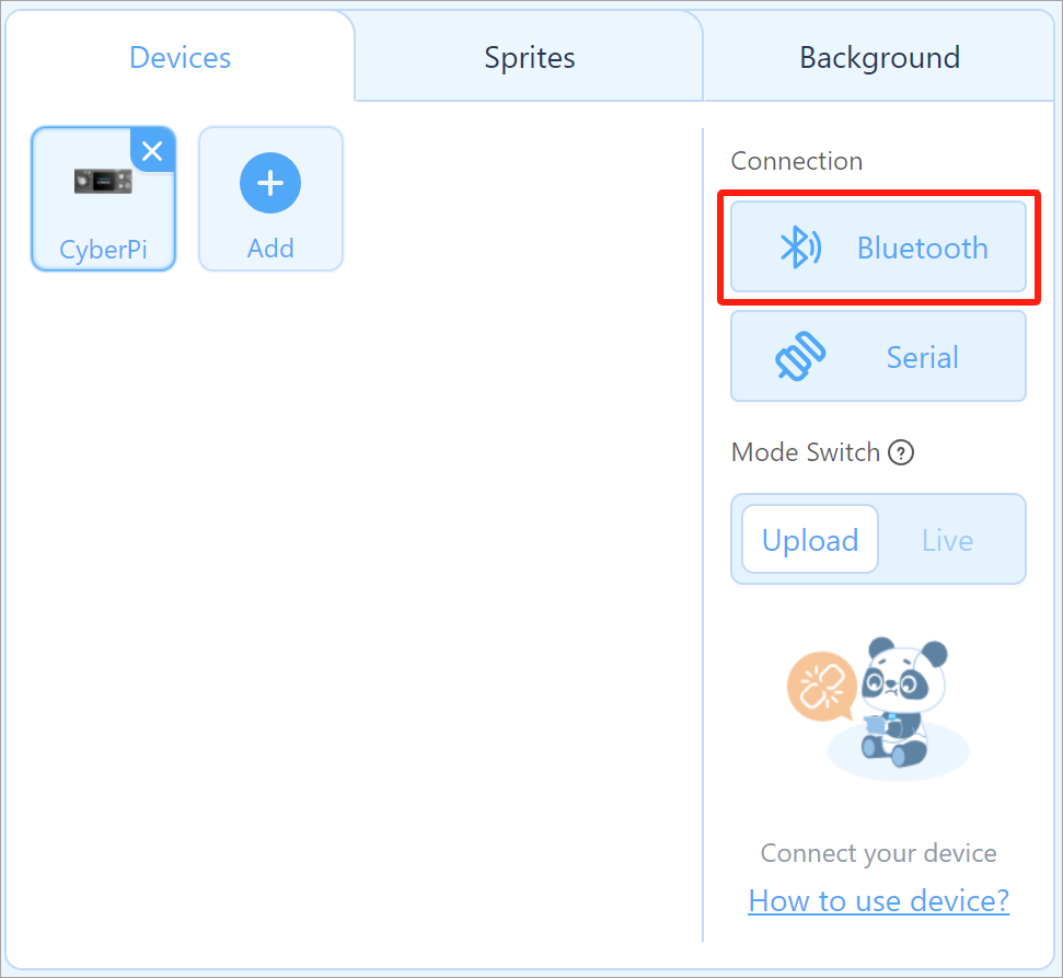

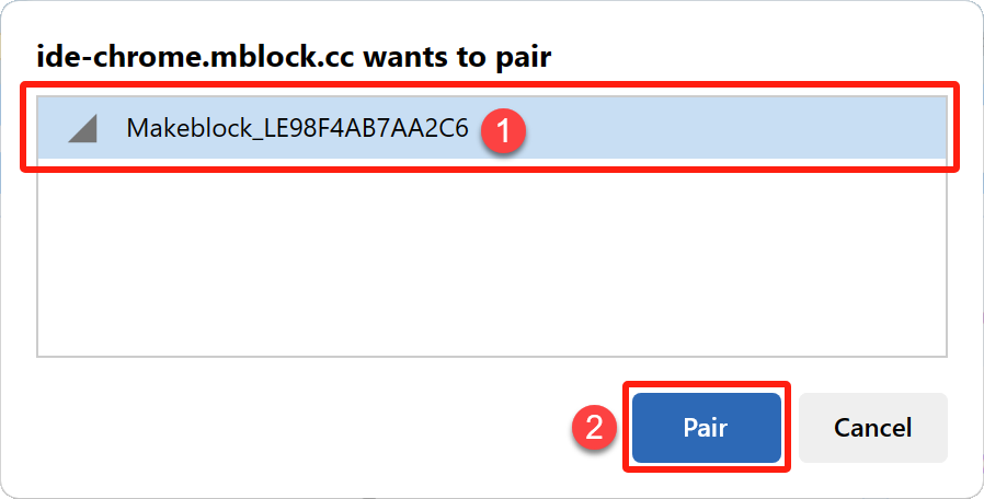

4. Click Bluetooth to connect your device.
5. In the window that appears, select the Bluetooth device, and click Pair.

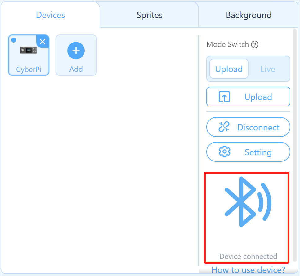

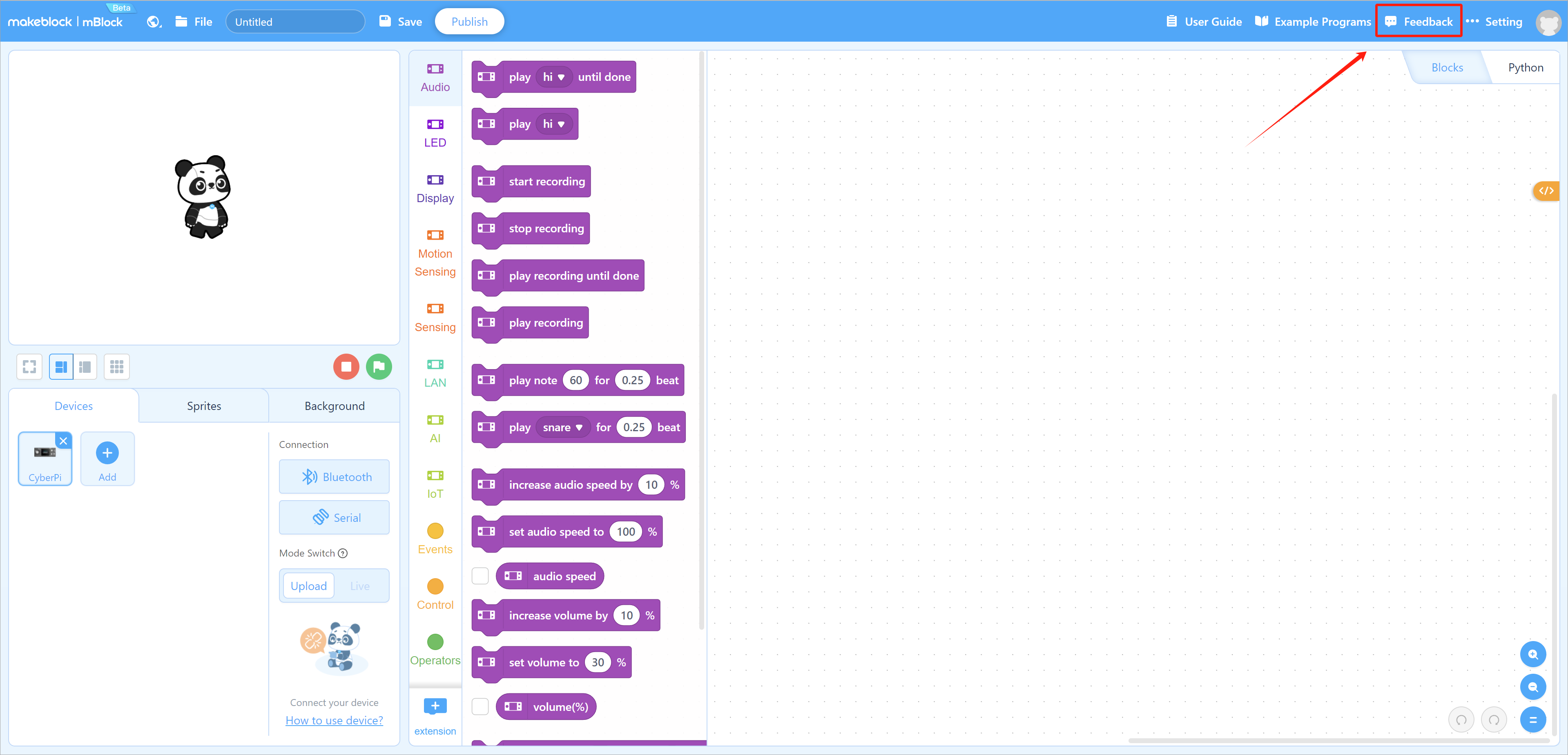

If your problem persists after the preceding steps, click Feedback in the upper right corner to describe the problem you've encountered. To resolve your problem more quickly, you are advised to attach pictures or videos about your problem. Makeblock customer service team will provide further support and guidance for you.
