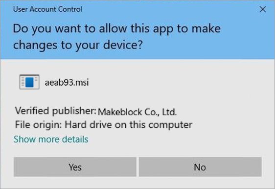

Problem 1: The app name displayed in the User Account Control window is incorrect during MSI package installation and uninstallation.
What happens
Cause
By default, the MSI uninstaller is installed in the folder C:\\Windows\Installer\ insread of the installation folder. Therefore, to tell the software and its version, a unique ID is generated randomly as the name. The folder is a hidden one in the system and may require access permission, which does not affect the use of the software.

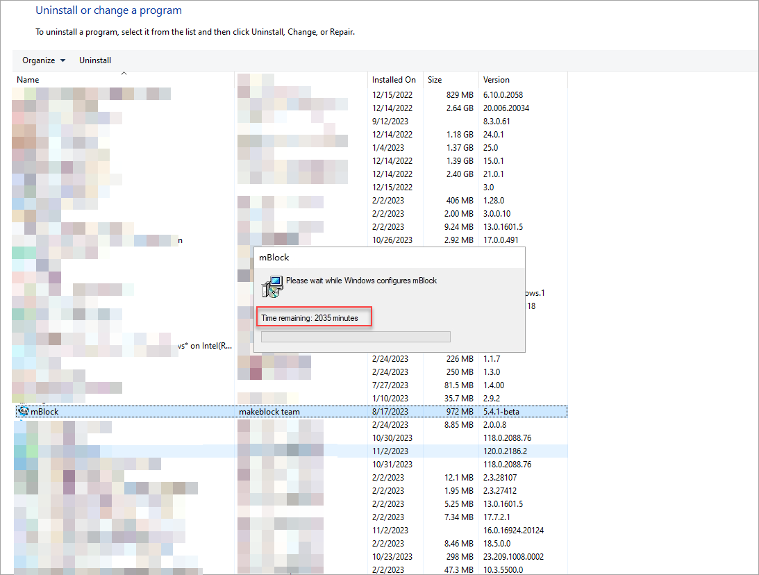

Problem 2: The uninstallation of the MSI package is slow.
What happens
The uninstallation is slow and the time displayed is incorrect. It may indiate that it takes more than 2,000 minutes, but in fact, the uninstallation has been done.
Cause
This happens due to the system mechanism. MSI installation and uninstallation is not simply done by running a program. It checks the status of the system, checks the status of the database that serves as a program to install the program, and then performs complicated calculation on how to coordinate the two parts. In addition, MSI installation and uninstallation involve registries to a large extent. As the system grows mature and the registries become larger or fragmented, MSI installation and uninstallation become slower.

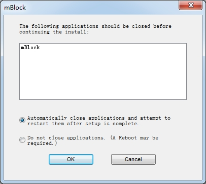

Problem 3: In the app closing reminder window that appears when the app is running and you attempt to uninstall it, you click OK to close the app but it still runs.
What happens
You click OK to close the app but it still runs.
Cause
When you click OK here, the closing of the app is supposed to be done by the Windows system. This is not about the app itself and does not affect the subsequent operation.

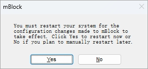

Problem 4: A restart reminder window is displayed during the uninstallation. If you click No, there will be folders remaining in the system.
What happens
Solution
Restart the computer after the uninstallation.

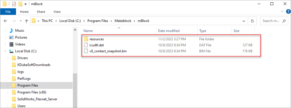

Problem 6: The installation path cannot be specified.
What happens
The command DEPLOY_DIR="D:\mBlock" cannot be used to specify another path for installation.
Solution
You cannot specify the installation path due to software path restriction. Changing the installation is not supported currently, but we will work on it in later versions.
