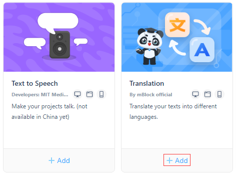

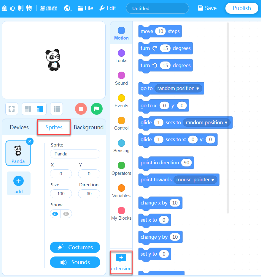

1. Click the Sprites tab and click + extension at the bottom of the Blocks area.
2. On the Extension center page that appears, click + Add at the bottom of Translation.

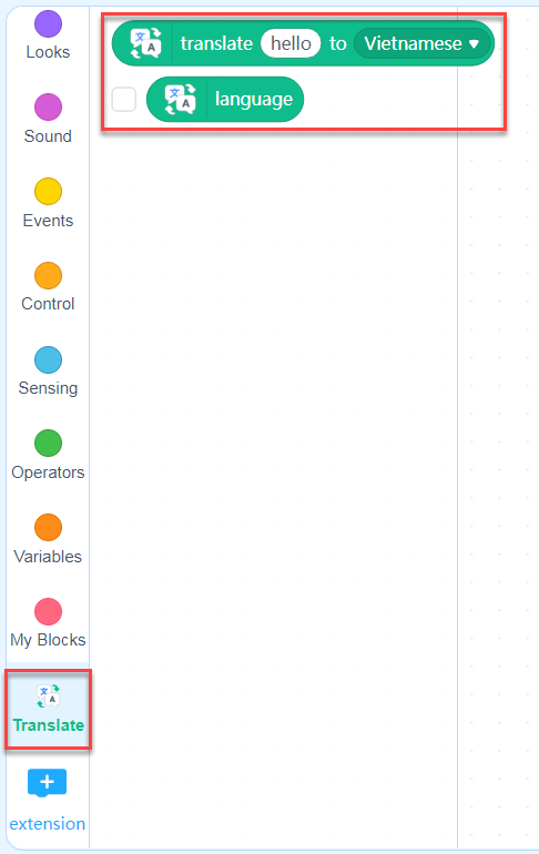

After being added, the extension and its blocks are displayed in the Blocks area.
Use the Translation blocks
The Translation blocks are all reporter blocks that must be used in combination with those requiring data.
The block translate ( ) to ( ) can be used for translation.

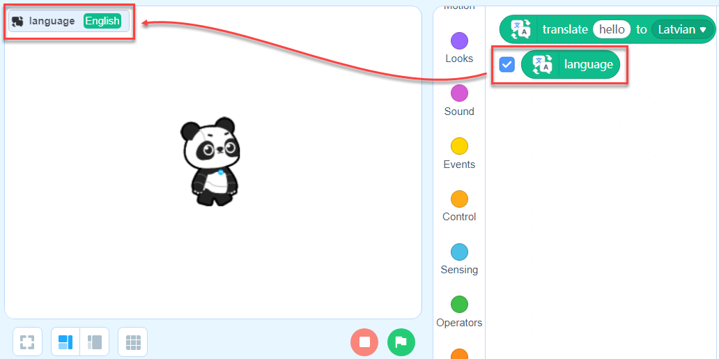

The language in the block language indicates the language used on mBlock 5.
You can click this block to see the language, or select the check box on the left of it to see the language on the stage.
