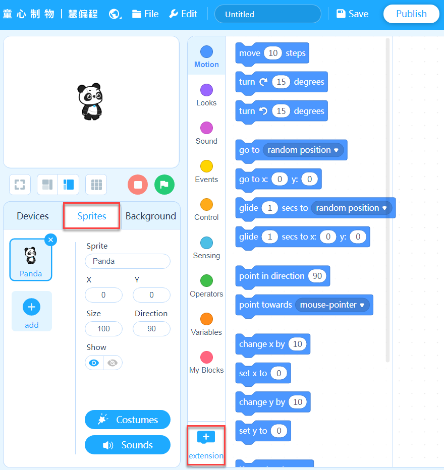

1. Click the Sprites tab and click + extension at the bottom of the Blocks area.

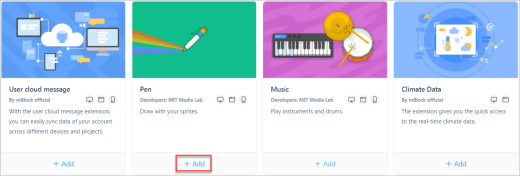

2. On the Extension center page that appears, click + Add at the bottom of Pen.

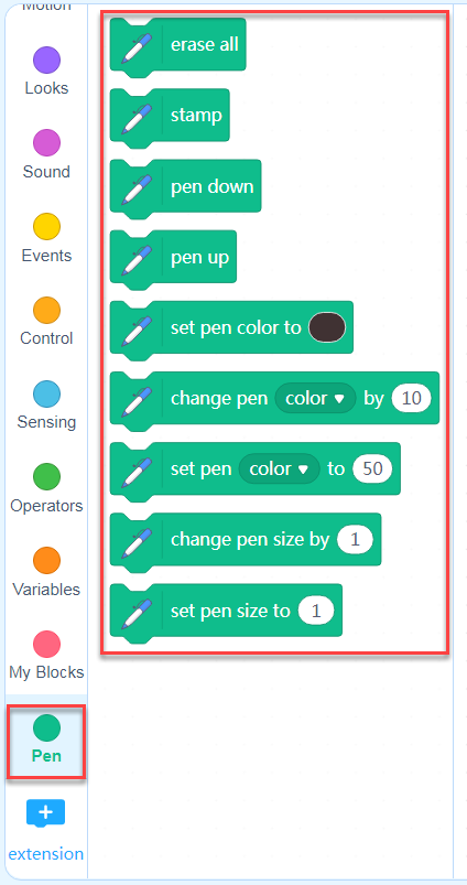

After being added, the extension and its blocks are displayed in the Blocks area.

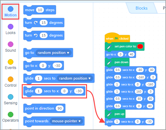

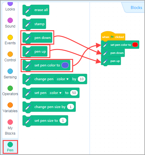

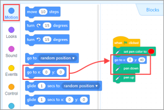

1. To paint a heart, you need to use the blocks set pen color to ( ), pen down, and pen up. You can drag all these three blocks to the Scripts area first.
2. Set the coordinates for pen down. In this script, let's set them to (0, 40).
3. Set the motion path of the sprite, enabling it to paint the pattern we want.
4. Set the sprite to move away after pen up to show the entire pattern.

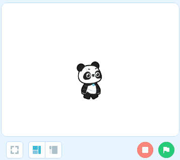

5. Click the green flag under the stage and then the sprite will paint a heart.
