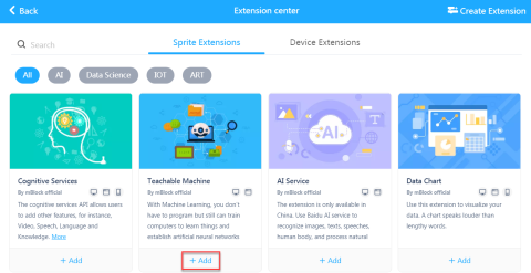

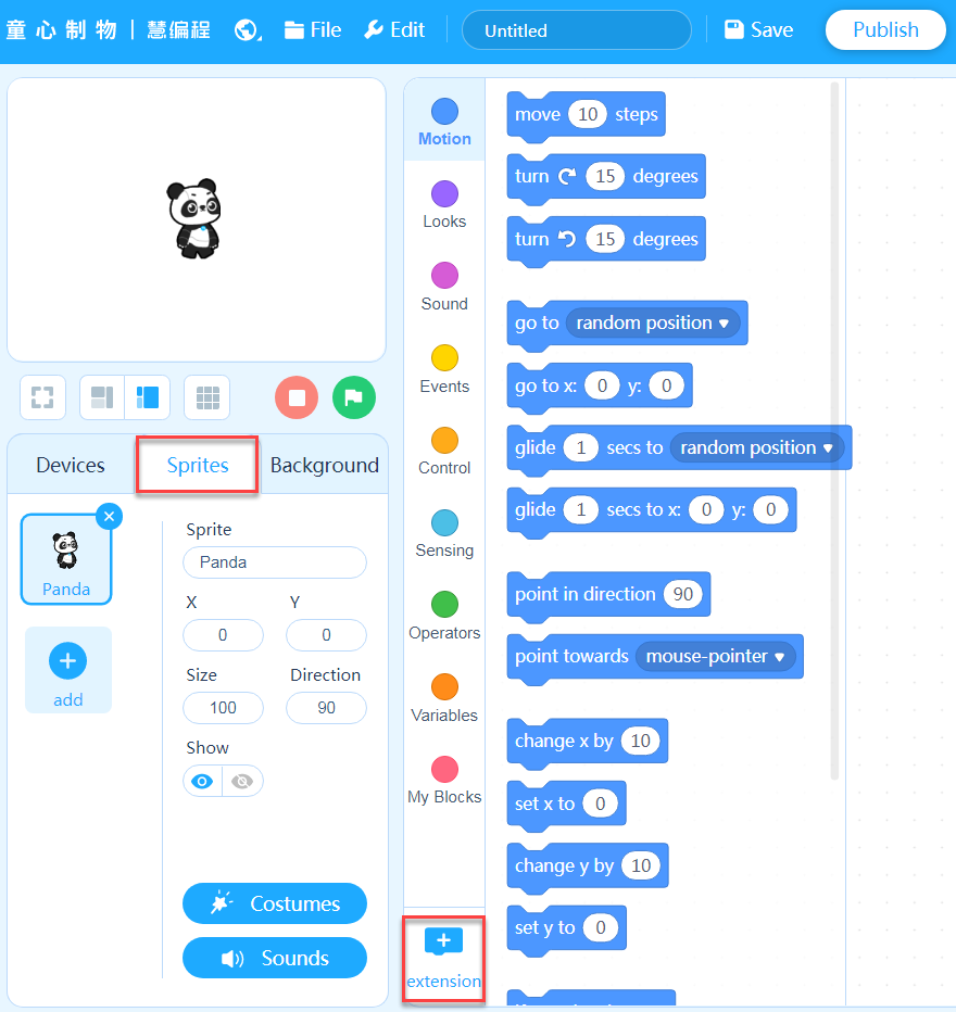

1. Click the Sprites tab and click + extension at the bottom of the Blocks area.
2. On the Extension center page that appears, click + Add at the bottom of Teachable Machine.
After being added, the extension and its blocks are displayed in the Blocks area.

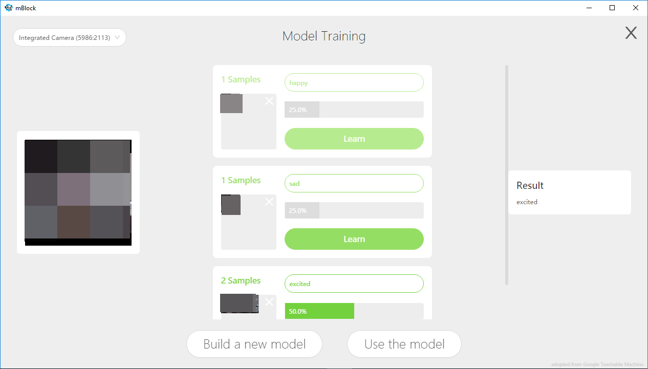

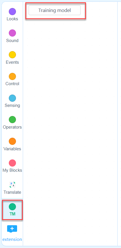

1. Choose TM in the Blocks area and click Training model. The Model Training page is displayed. Name the three categories happy, sad, and excited. Click Learn for each category to add samples. After the learning is complete, click Use the model.

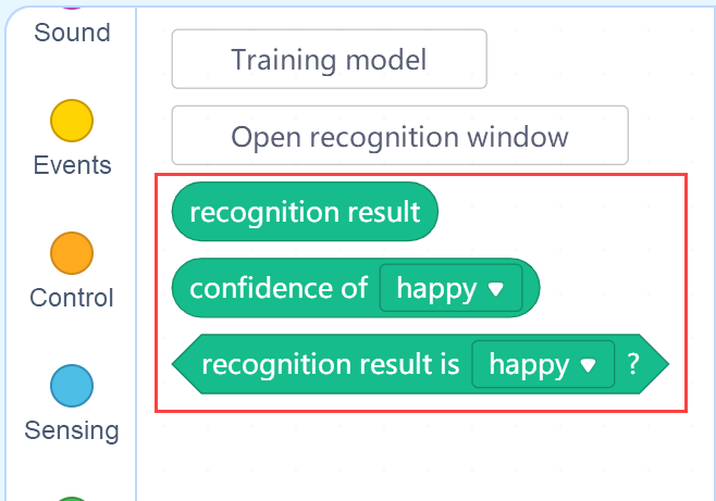

2. After you create a model, new blocks are provided in the TM category.
3. Enable Panda to recognize your emotions based on the created model.

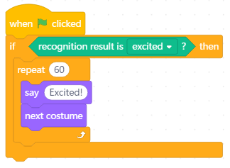

Program Panda as follows:
Panda dances and says "You're excited!" when it recognizes that you are excited.

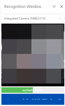

4. Click the green flag under the stage to execute the program.
The learning window is displayed. When the recognition result is excited, Panda dances and says "You're excited!"
