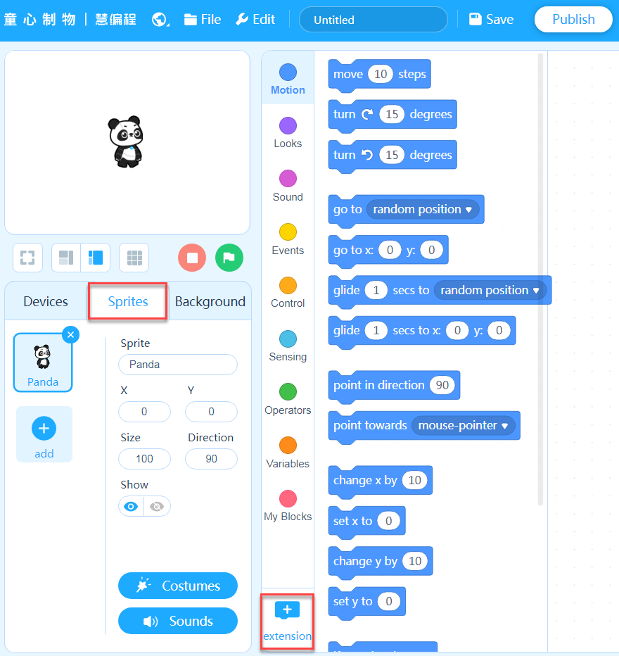

1. Click the Sprites tab and click + extension at the bottom of the Blocks area.

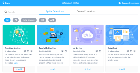

2. On the Extension center page that appears, click + Add at the bottom of Cognitive Services.
After being added, the extension and its blocks are displayed in the Blocks area.

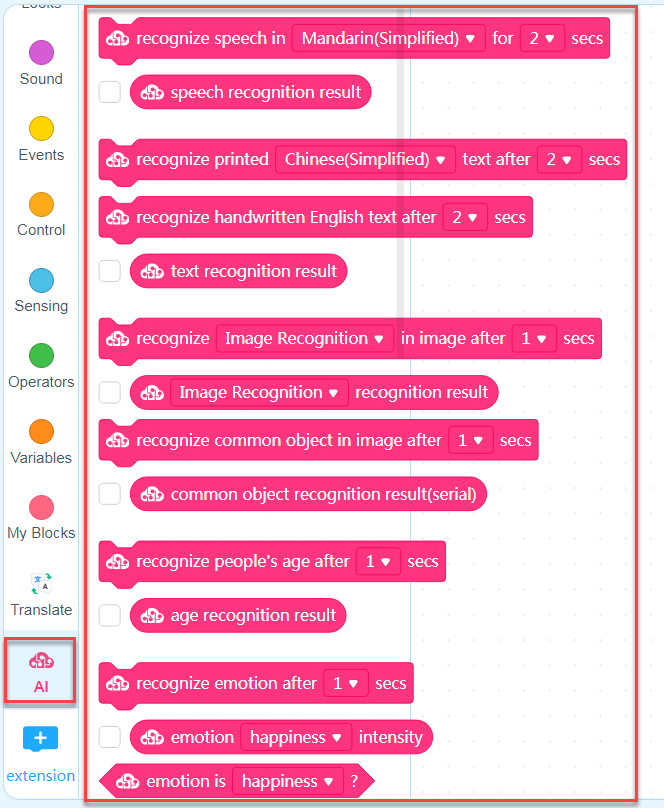

Use the Cognitive Services blocks
Try to use the Cognitive Services blocks.

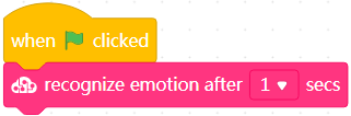

  1. Program Panda as follows:
With this program, Panda recognizes your emotion for two seconds after you click the green flag.

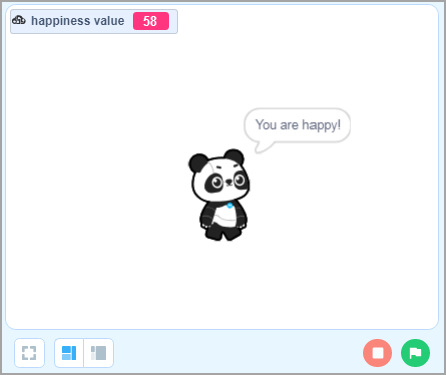

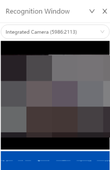

  1. Now, execute the script. When you click the green flag, the recognition window is displayed, and Panda recognizes your emotion in two seconds. The recognition result is displayed on the stage. The value 58 indicates that you are happy, and thus Panda says "You are happy!"
