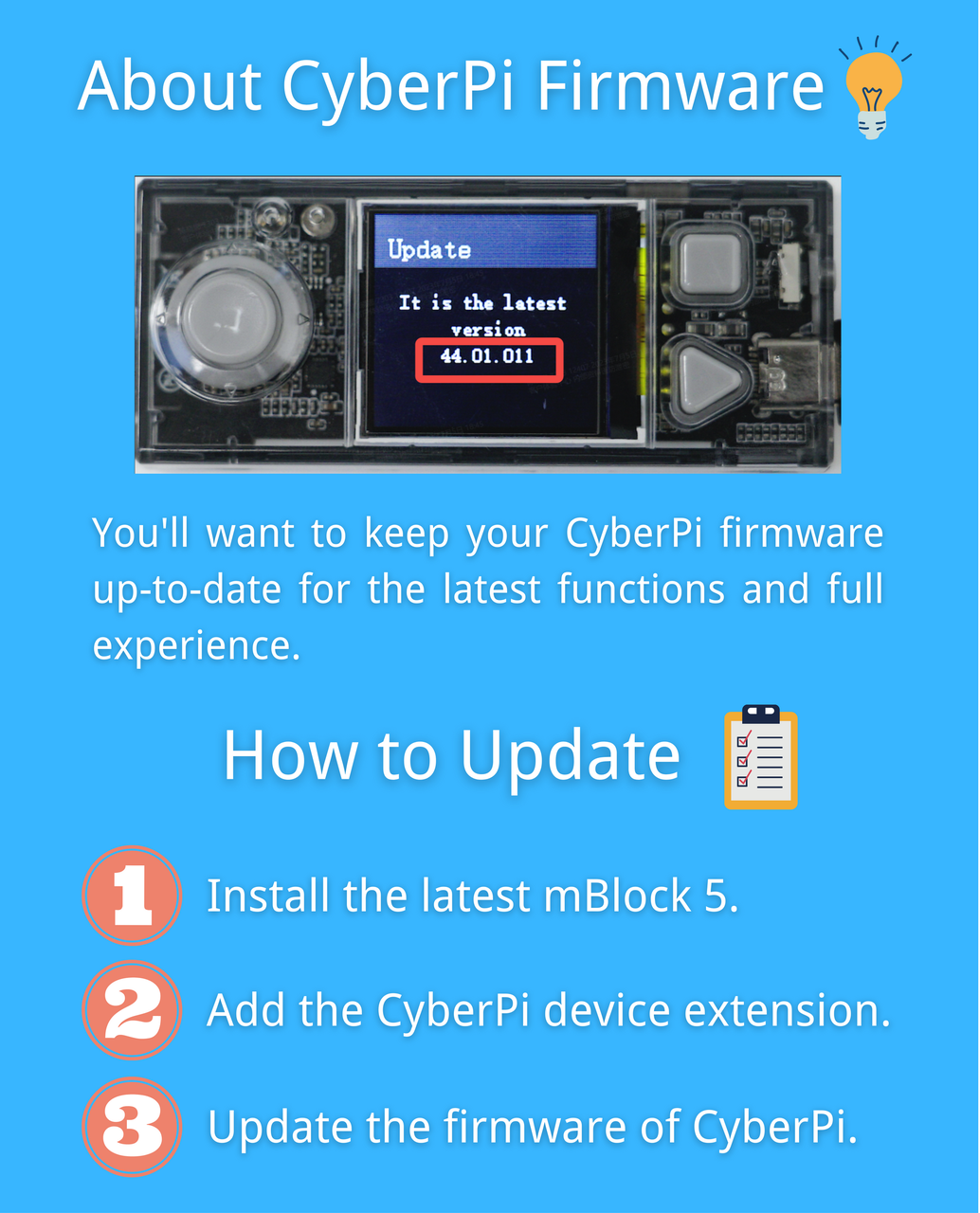

The firmware may not be the latest version.

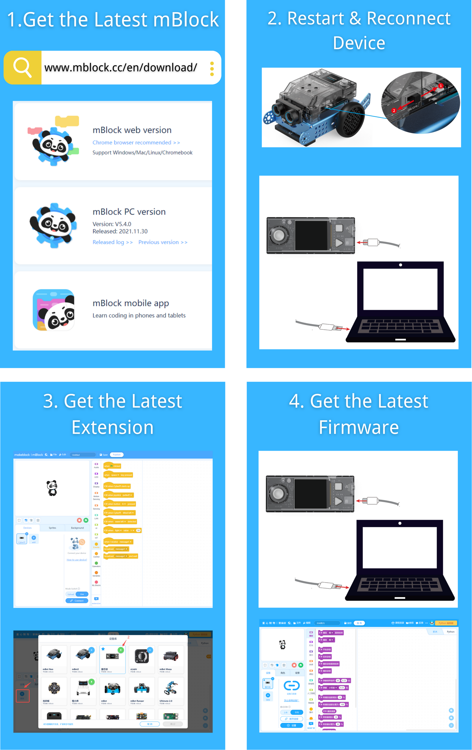

  1. Please update the firmware of CyberPi and mBot2 shield to the latest version.
  2. After the updating is completed, turn on the switch on the mBot2 shield.
