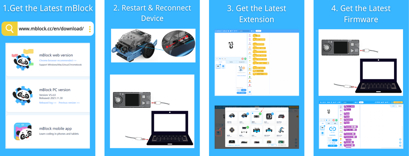

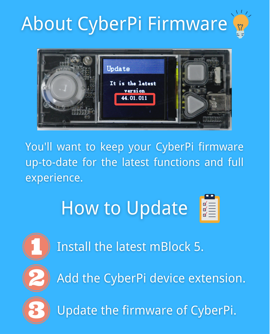

Possible Cause 1: Old Firmware
Solution: Update CyberPi's firmware to the latest version.
For details, please see this guide:
https://support.makeblock.com/hc/en-us/articles/15810997673495

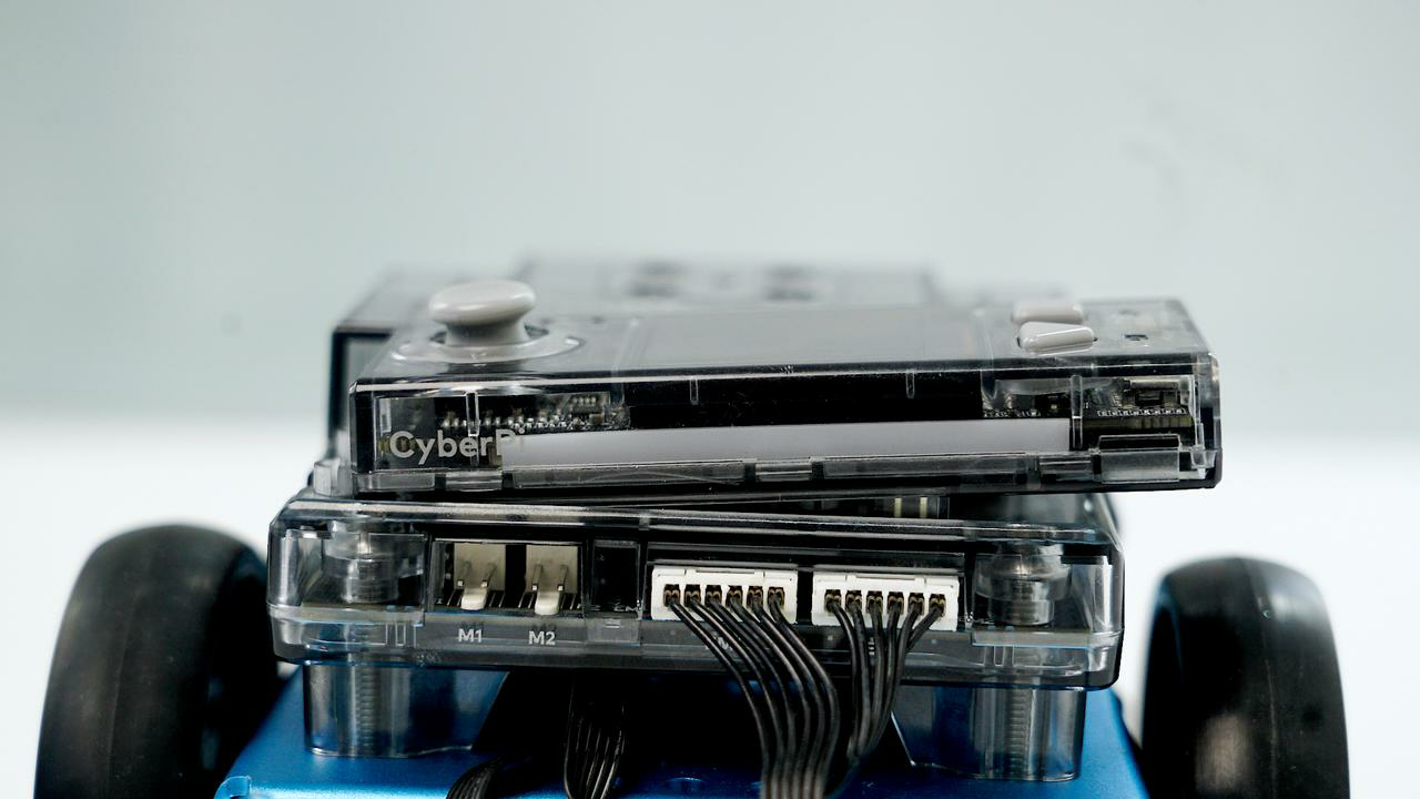

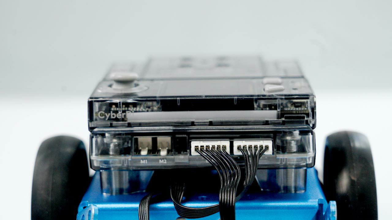

Possible Cause 2: CyberPi Mounted Improperly
For example, the CyberPi isn't fitted onto mBot2 as shown below.
Please fit CyberPi to mBot2 and press down firmly to make sure.

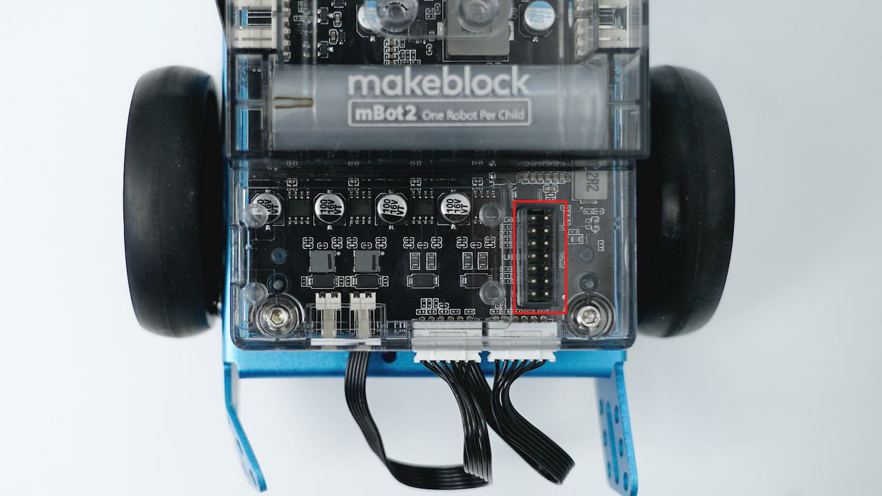

Possible Cause 3: Port Pin is Bent or Damaged
Solution: Please check the port pin and contact support for advice.
