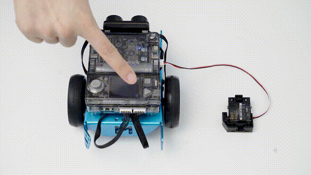

Not sure how to connect the servo motor to mBot2?
See below
Not sure how to check the servo motor's response?
See below
If the servo motor doesn't respond, please move on to possible cause 2.
If the servo motor responds in the same way above, your program has a bug.
Please debug your program and check again if the engine is able to rotate.
