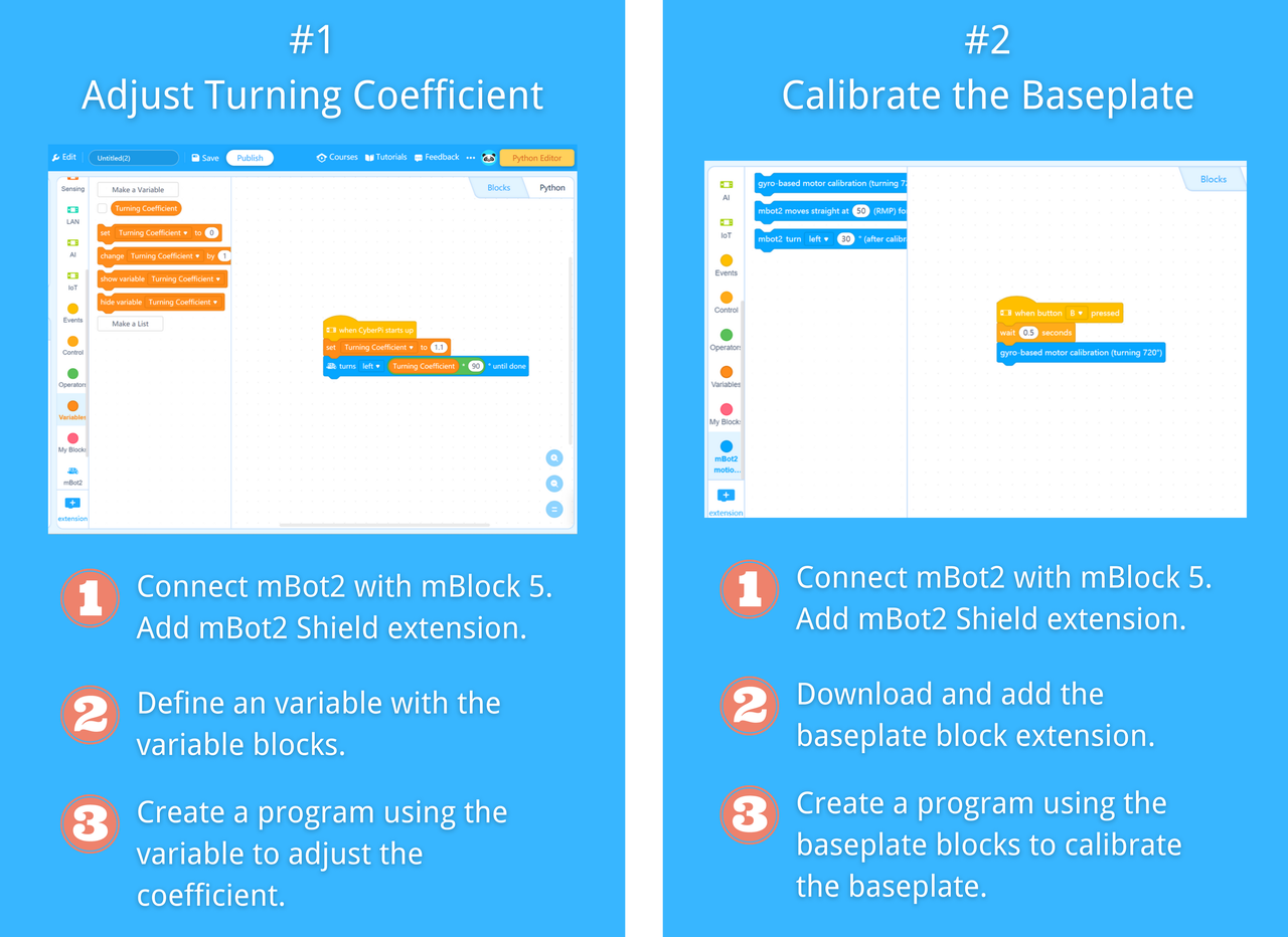

Option 1, Adjust the Turning Coefficient

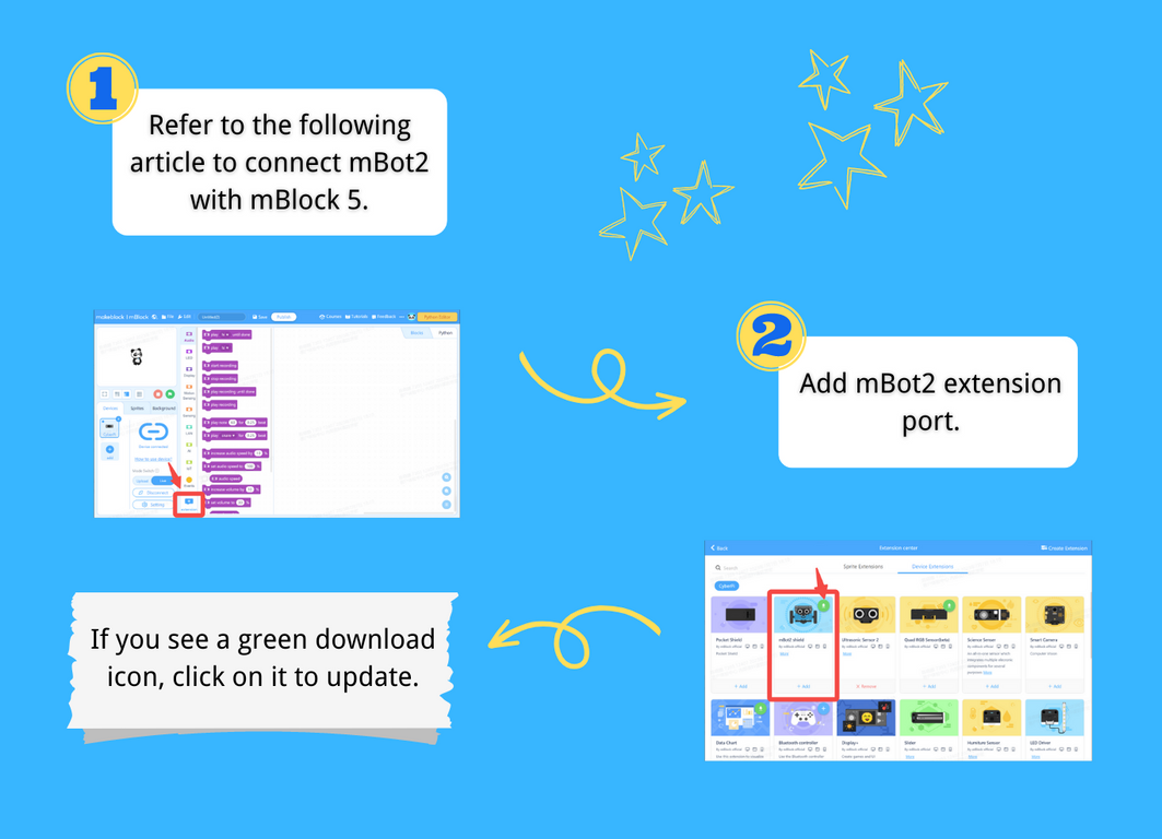

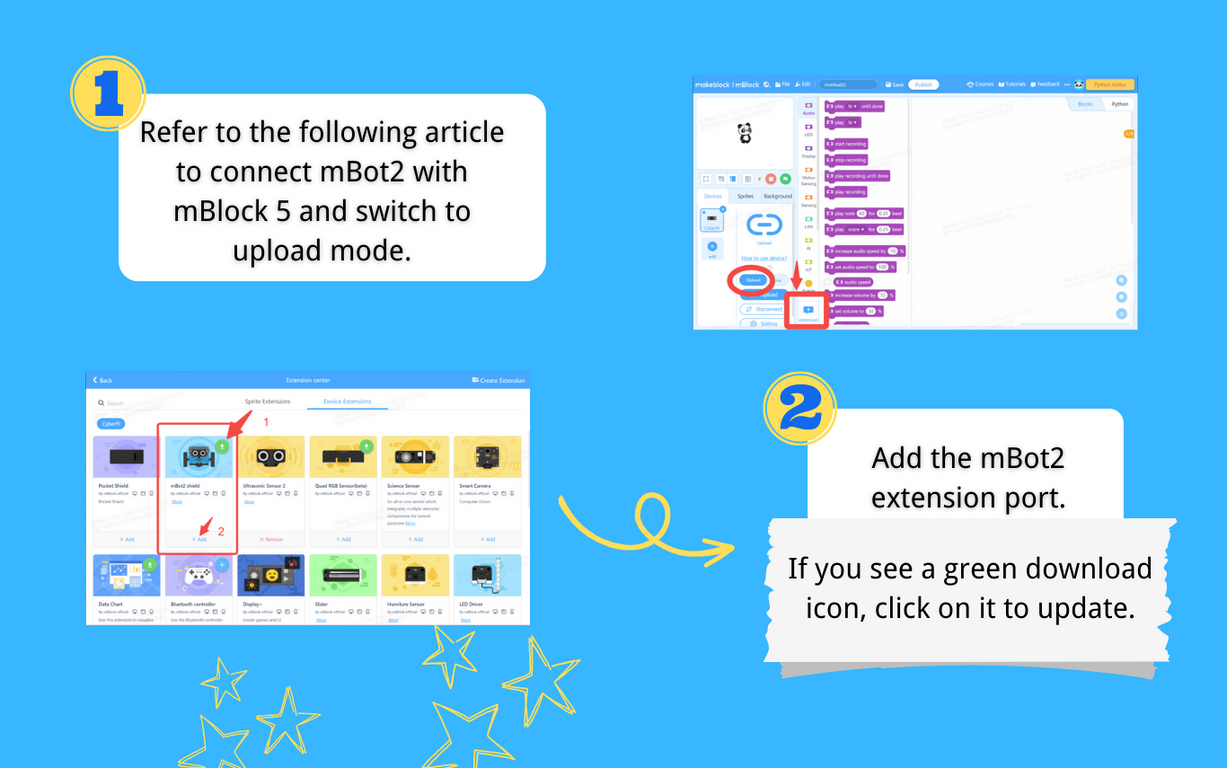

1. Connect mBot2 and mBlock 5. Add the mBot2 extension port.
For details, please see this guide: https://support.makeblock.com/hc/en-us/articles/15850718565399

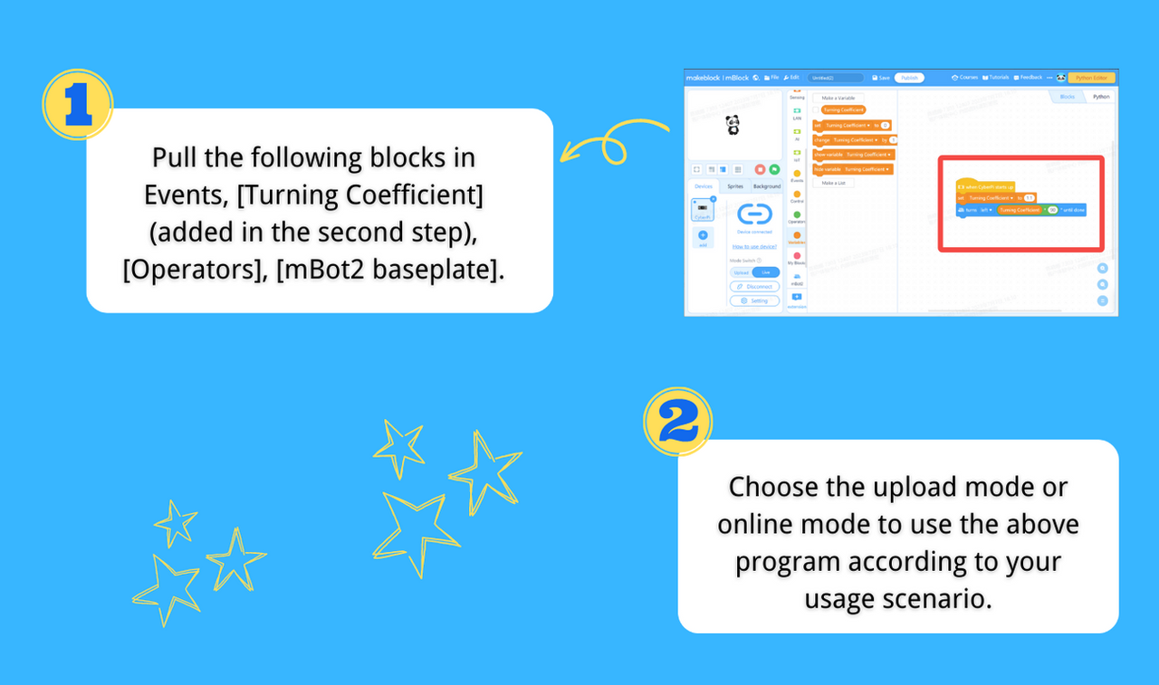

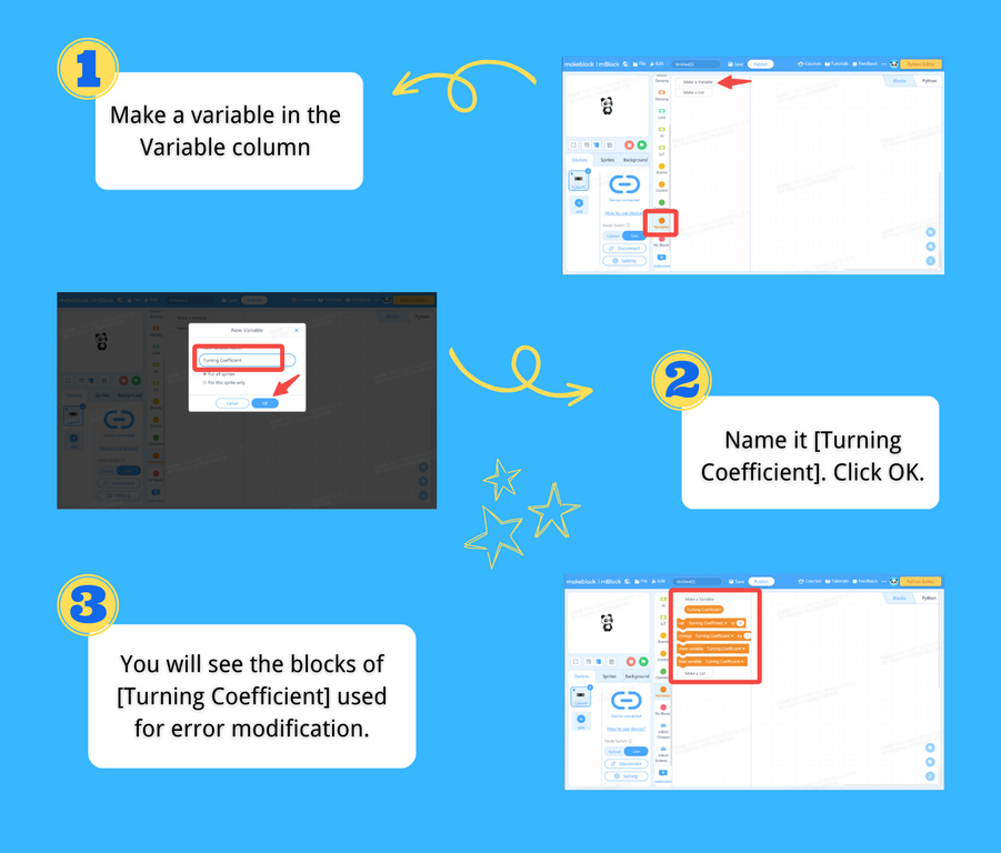

2. Define the Turning Coefficient variable with the variable blocks.
3. Create a program with the variable to adjust the coefficient.

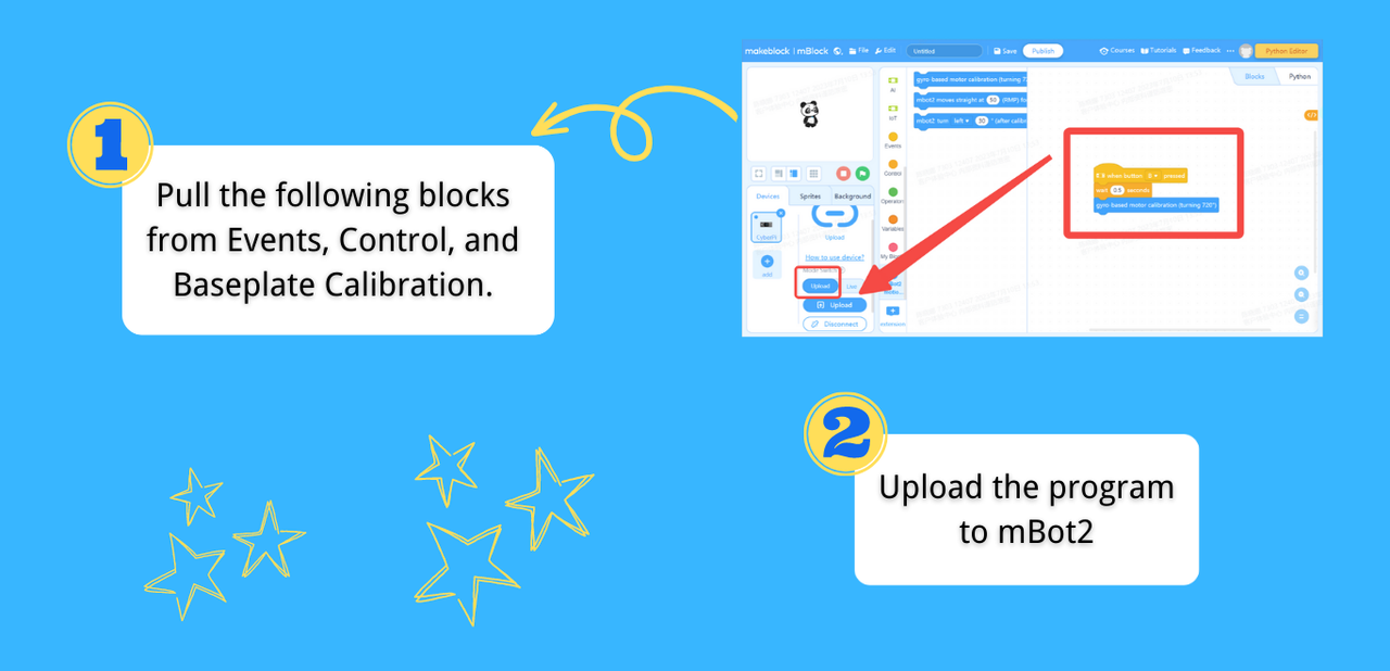

#2 Calibrate the baseplate of mBot2

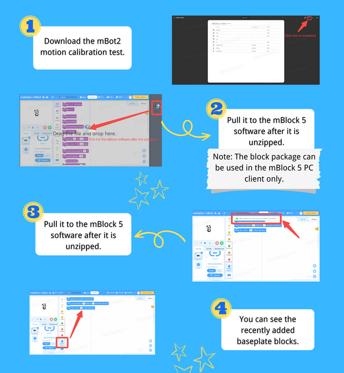

2. Download the block package for baseplate calibration.
3. Upload the program designed from baseplate calibration blocks to calibrate the baseplate.
After uploading the program, press button A on CyberPi and the indicator will light on.
After the mBot2 car completes a 720° rotation, it needs to wait for the gyroscope reading to stabilize before the calibration is considered complete (the indicator light will go off at this point).
The calibration coefficients obtained will be saved in the Makeblock board and will not be lost even if power is disconnected.
