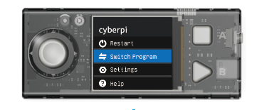

#3 Check the Line Following Function
1. Press Home Button on the left side.
Tap Switch Program, and press Button B
Push the joystick to the left to enter the programming interface.
Move down the joystick and select "mBot2_demo2".

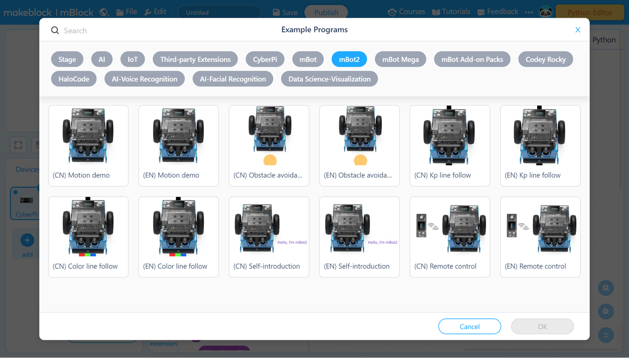

2. Check if mBot2 follows the line properly.
If yes, the sensor may need to be calibrated again, or the line following program may be faulty and need to be improved according to the example program in mblock v5.4.0 app as shown in the photo below.
