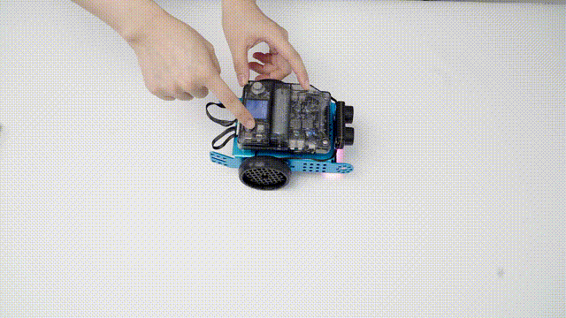

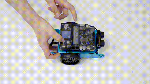

Step by Step
Exchange the motor cable to confirm if it's the motor or the mBot2 Shield is faulty.
#1 If the rotation direction changes from clockwise to counterclockwise or vice versa:
This confirms that one of the motors is faulty.
#2 If the car cannot move at all after the motor cables are exchanged:
The mbot2 extension board may be faulty.
