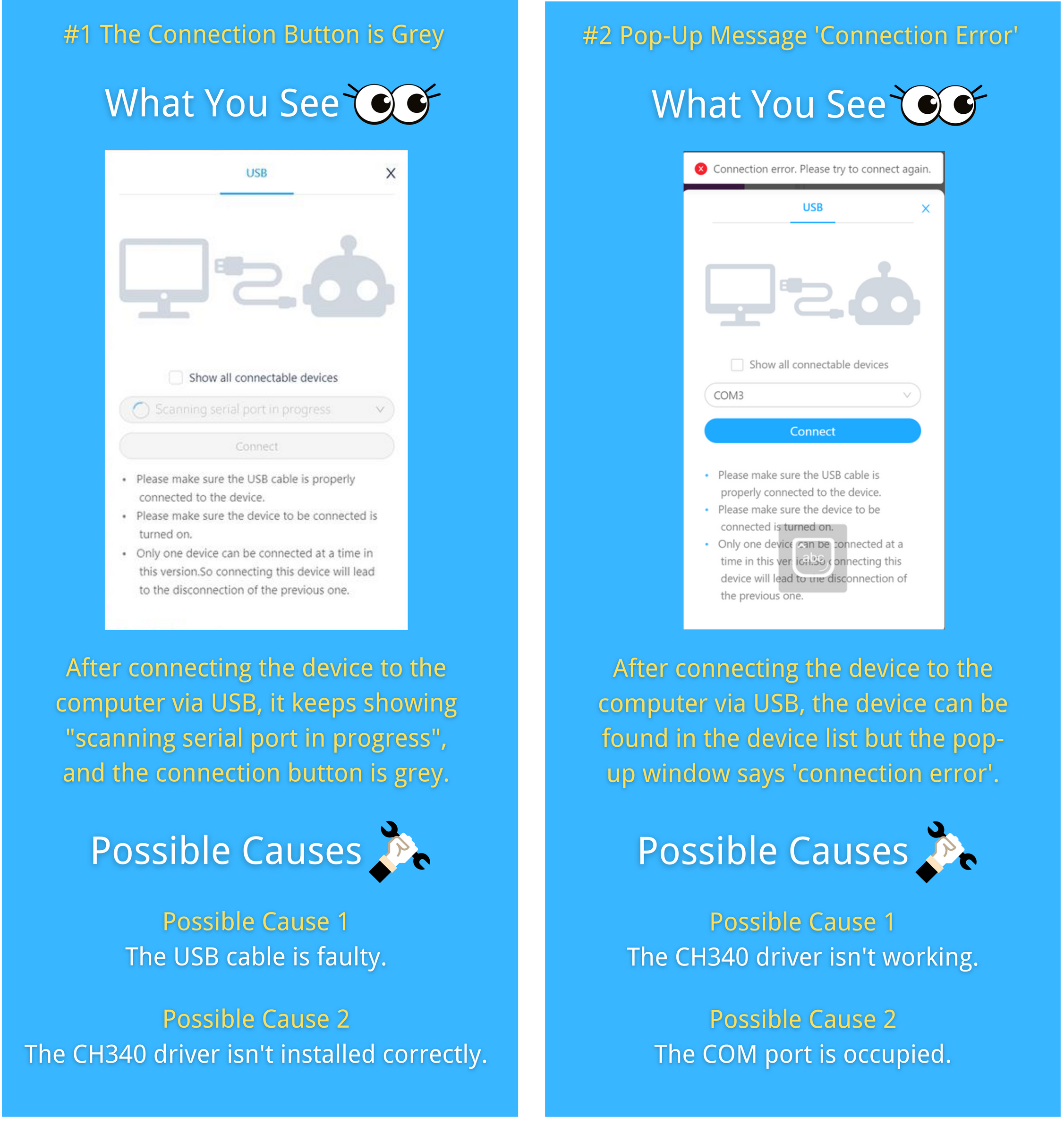

You may encounter different situations. Here we list two issues frequently asked.
Step by Step
The Connection Button is Grey
After connecting the device to the computer via USB,
mBlock 5 keeps showing "scanning serial port in progress",
and the connection button is inactive.

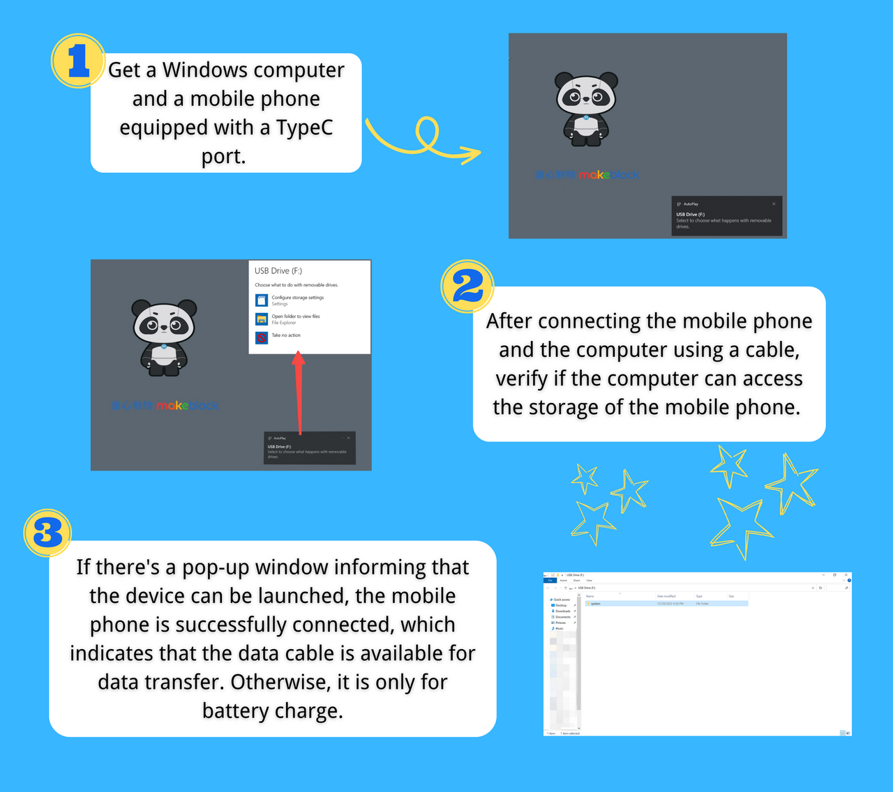

Possible Cause 1: The USB Cable is Faulty
Follow the steps below to troubleshoot.
Not sure if your data cable support data transfer? See the steps below.

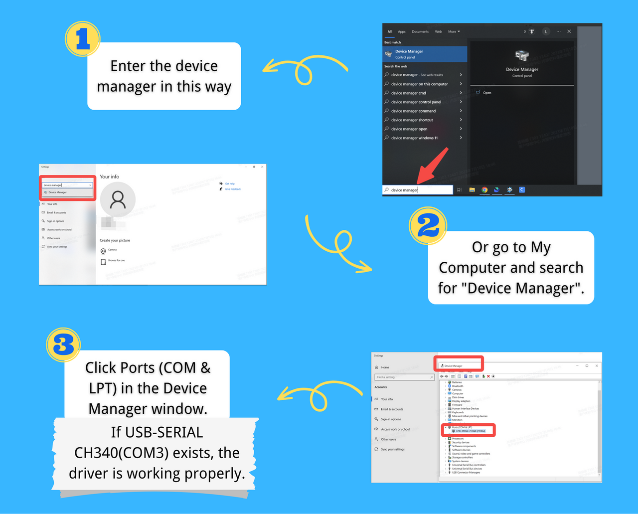

Possible cause 2: The CH340 Driver isn't Installed Correctly
Please follow the steps below.
Go to the official website to download the CH340 driver:
Not sure how to check if the installation is successful? See the steps below.

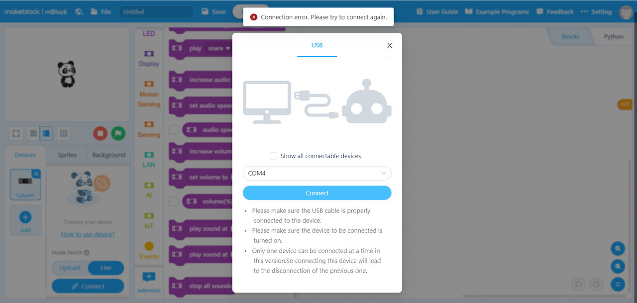

The Connection Error Message
After the device is connected to the computer via USB,
a pop-up window on mBlock 5 shows that Connection failed though the port is found.

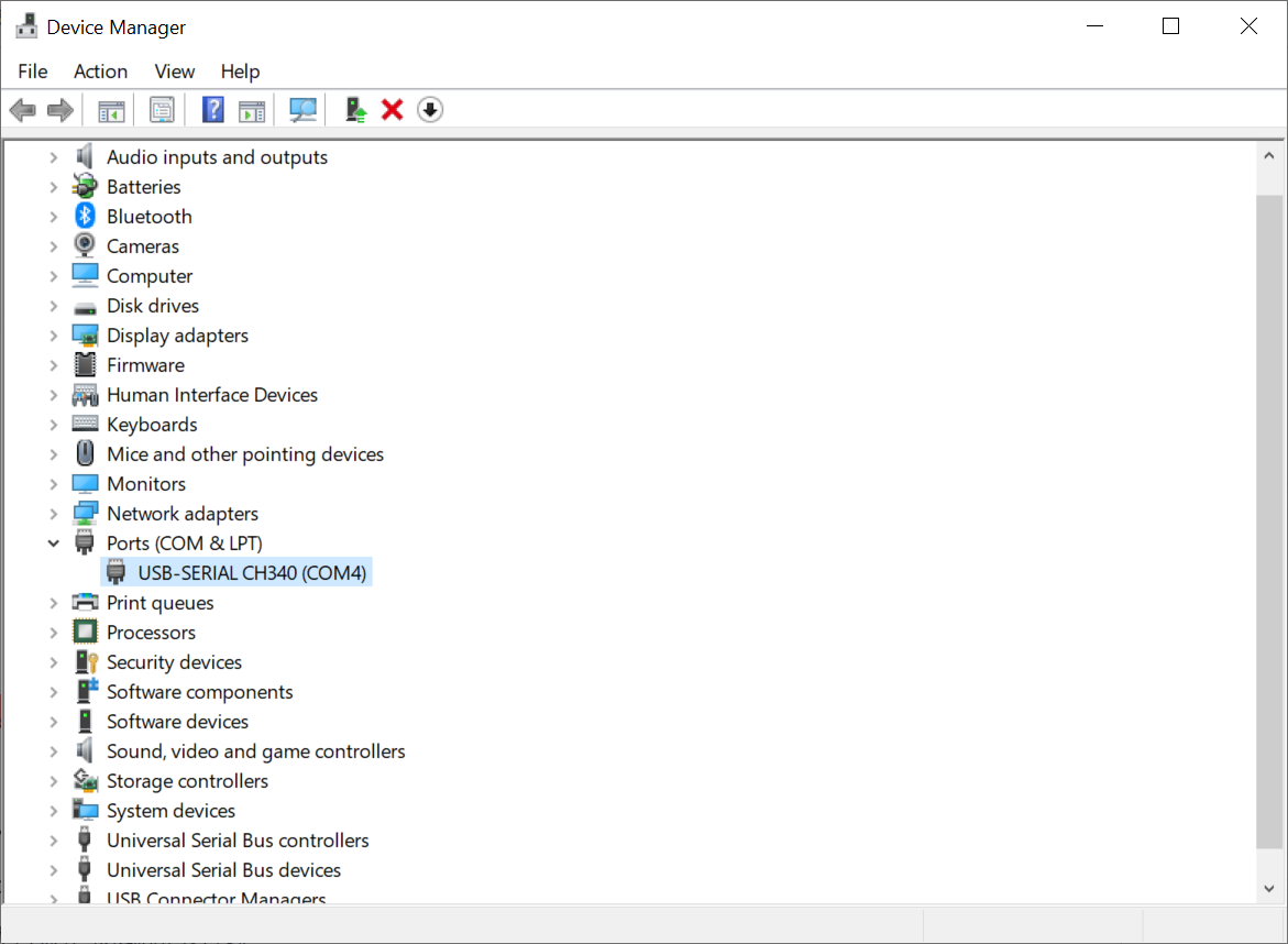

Possible Cause 1: The CH340 Driver isn't Working
Please refer to the following steps to check if the CH340 driver is working properly.
Not sure how to reinstall the driver? See the steps below.
Possible Cause 2: The COM Port is Occupied.
You may find mBlock 5 cannot be connected even if the port looks fine in the device manager. This happens if the port is occupied by a device before mBot2 is connected.
Please follow the steps below to troubleshoot.
