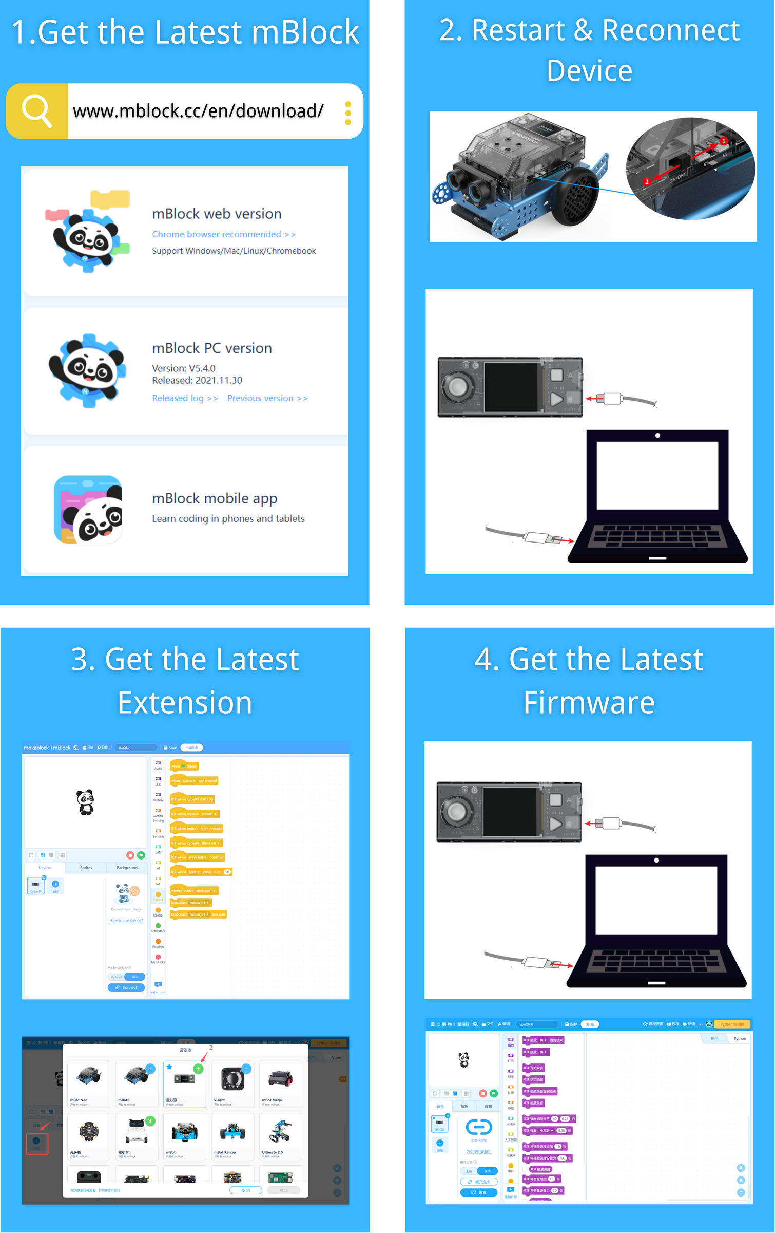

Routine Check
Refer to the quick steps below to rule out basic issues.
例行检查图四张一组

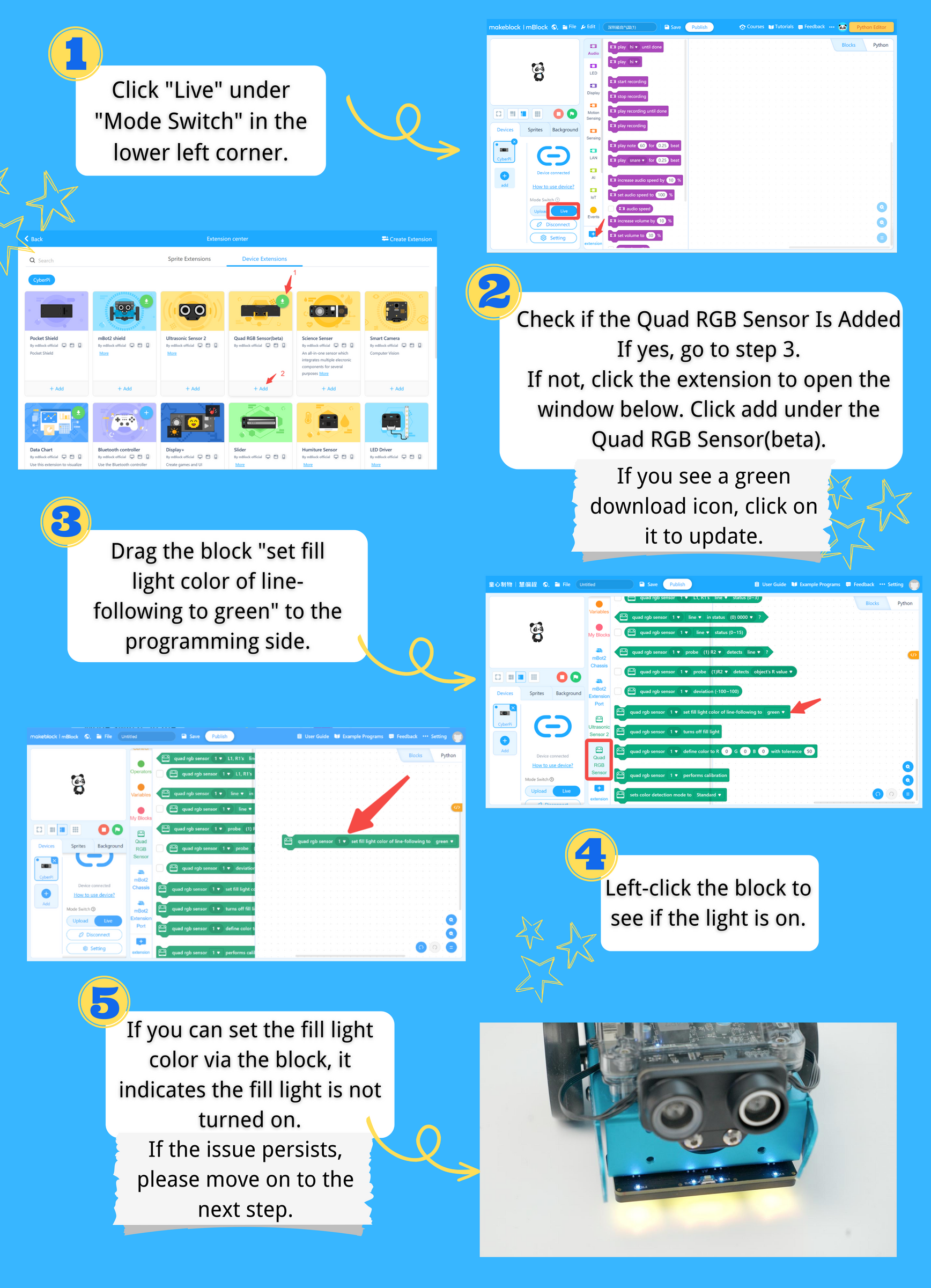

In a Nutshell
Possible Cause 1:
The Fill Light isn't Configured in mBlock 5.
Not sure how to connect mBot2 to mBlock 5? See below:
https://support.makeblock.com/hc/en-us/articles/15850718565399
