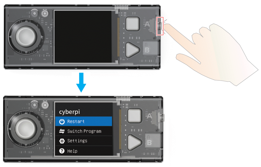

#1 Go to CyberOS's Home Screen
Press the Home Button on the Right Side of Cyberpi to Enter the Homepage
复用图-CyberPi

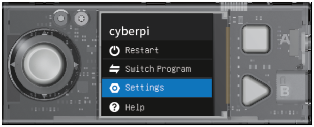

#2 Go to 'Settings'
Move the joystick up and down, select 'Settings', and press Button B to Enter.
复用图-CyberPi

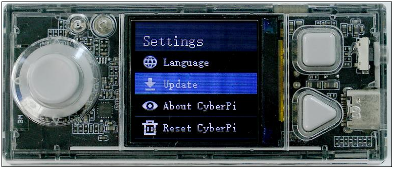

#3 Go to 'Update'
On the Settings Page, select Update by moving the joystick up or down,
Select 'Update' and press Button B to enter the update screen.
复用图-CyberPi

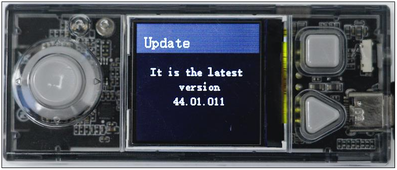

#4 View the Version
复用图-CyberPi
