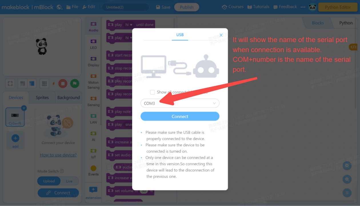

Possible Cause 1: Check the Pairing
If the Bluetooth adapter pairing fails, the connection window of mBlock will not show the serial port.
Refer to the article to connect CyberPi/mBot2 to the computer via the Bluetooth adapter.
