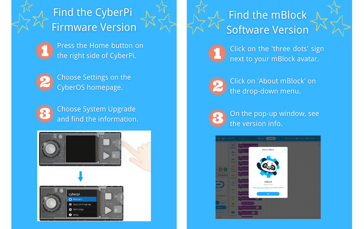

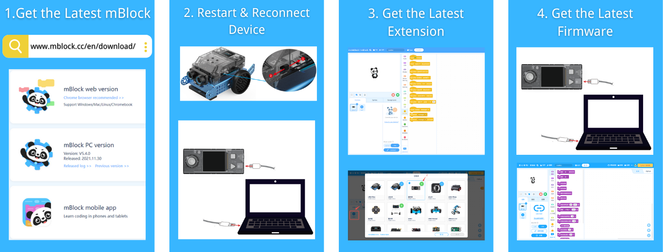

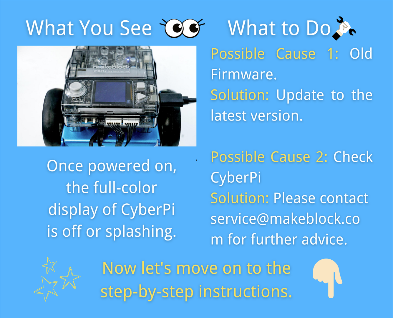

Possible Cause 1: Faulty Firmware
#1 Please update the firmware to the latest version.
#2 After the updating is completed, unplug and replug the USB connection cable or turn on the switch on the pocket shield/mBot2 shield.
#3 After the updating is completed, check if the full-color display of CyberPi is on. If not, move on to the next step.
Not sure how to update the Cyberpi firmware mentioned above? See the link below:
How to Update CyberPi Firmware
Possible Cause 2: Faulty CyberPi
After the updating is complete, if the full-color display is still off, CyberPi may be faulty.
Please contact customer support for further advice.
