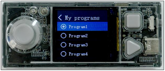

#1 Find My Programs in CyberOS
For details, please refer to this guide:
How to View and Switch Between Preset Program and My Program

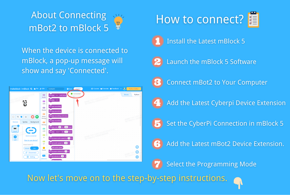

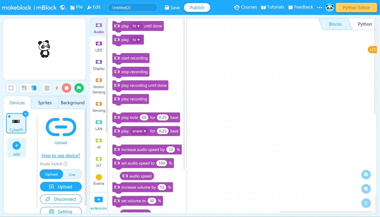

#2 Connect the Device to mBlock 5
After the connection is done, switch to upload mode.
For details, please see these guides:
How to Connect mBot2 to mBlock 5
How to Connect CyberPi to mBlock 5

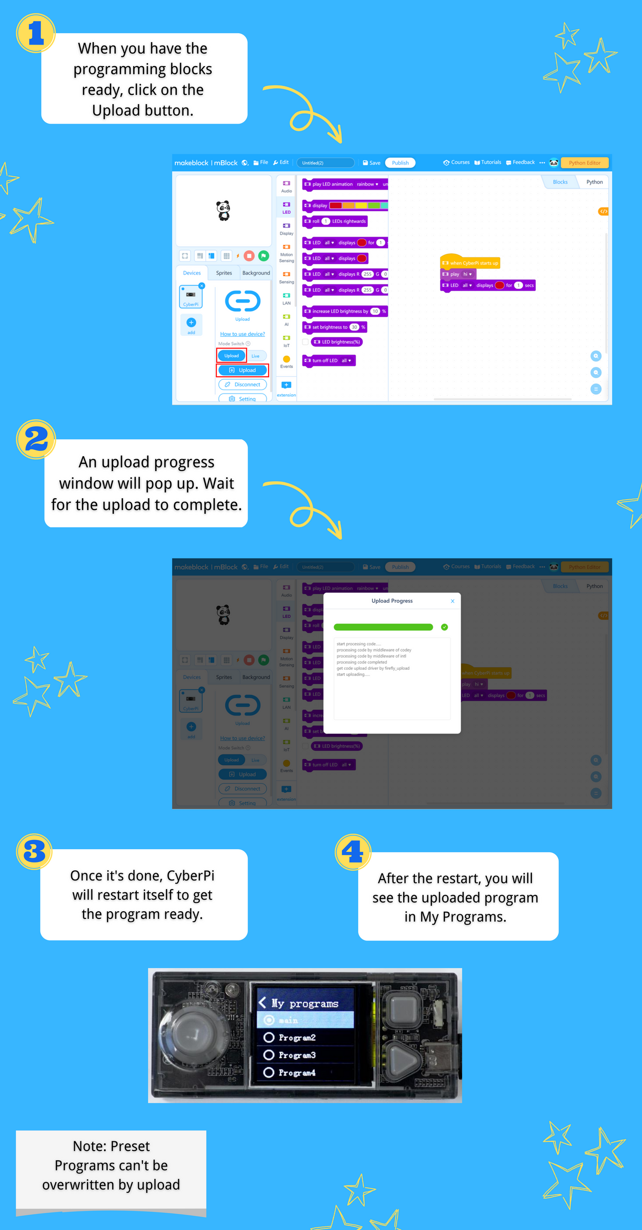

#3 Upload the Program to CyberPi

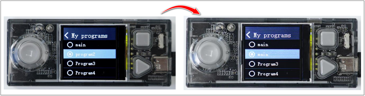

Tips 1: Upload to a Different Program Slot
1. The uploaded program will be named 'main' and overwrite 'Program 1' by default.
2. If you want to upload your program to another slot, select that slot and run it.
The system will then send the new program to that slot specifically.
3. You can name your program by using the mBlock 5 web version.
This will help you tell different programs with names.

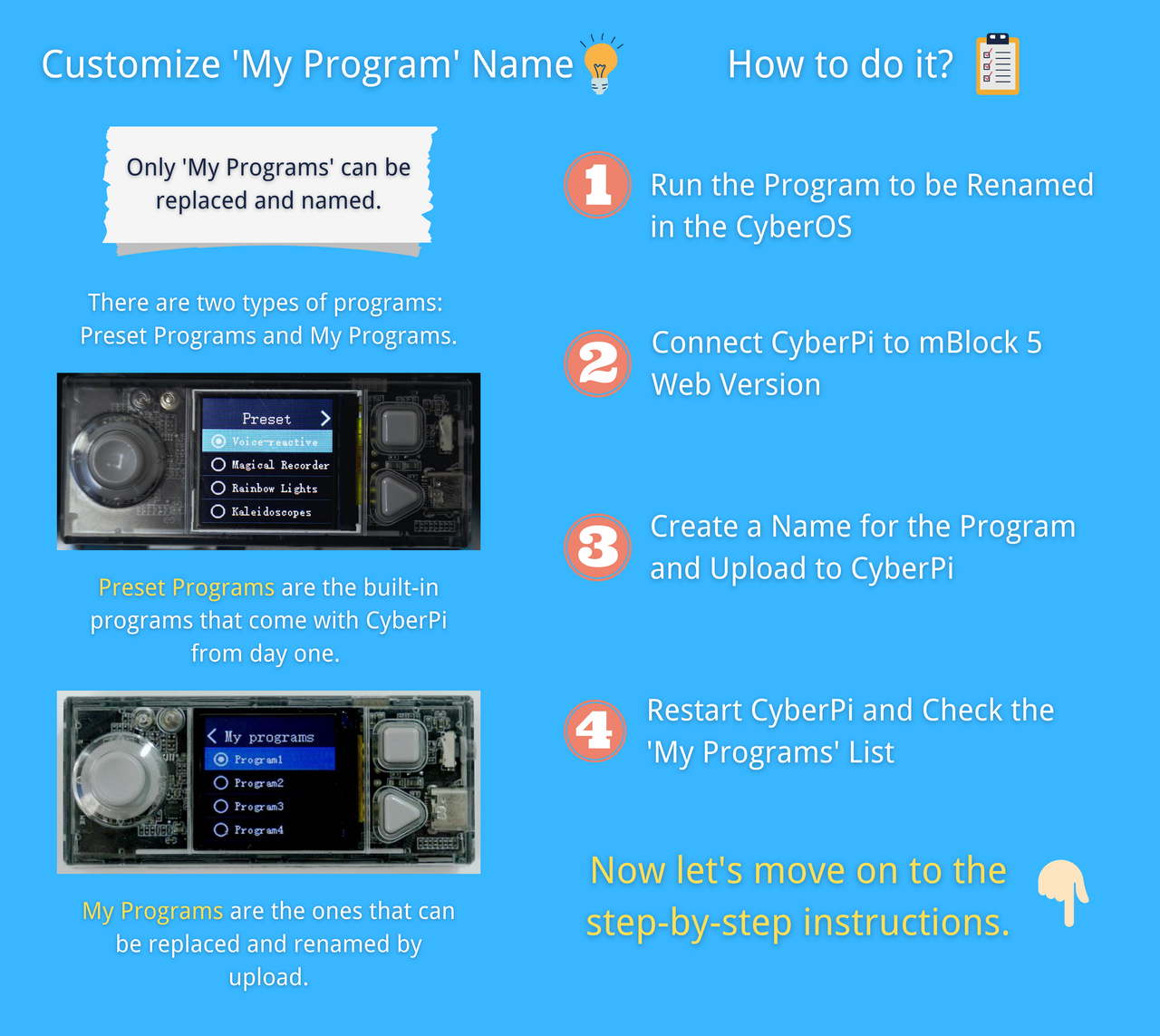

Tips 2: Customize My Program Name
Currently, program names can only be customized in the mBlock 5 web version.
For details, please see this guide:
