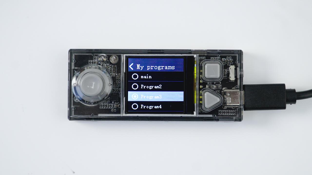

#1 Run the Program to be Renamed
Go to 'My Programs' and select the program and press Button B to run it.
Refer to this article below to switch to My Programs.

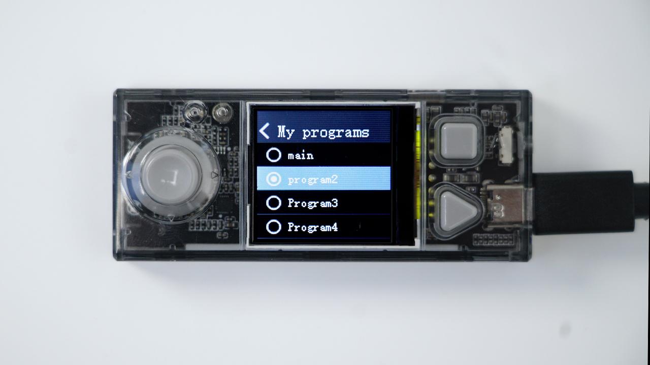

#5 Restart CyberPi and Check the 'My Programs' List
After the uploading is completed, reboot CyberPi and switch to My Programs.
Program 3 is covered by the name of the uploaded program.
Note:
  1. Upload a program to My Programs via CyberPi, program1 will be covered and the name is "main".
  2. If you want to upload the program to others, you need to get the CyberPi to run My Programs.
  3. Before uploading, if CyberPi is running Program2, it will upload the new program to Program2.
