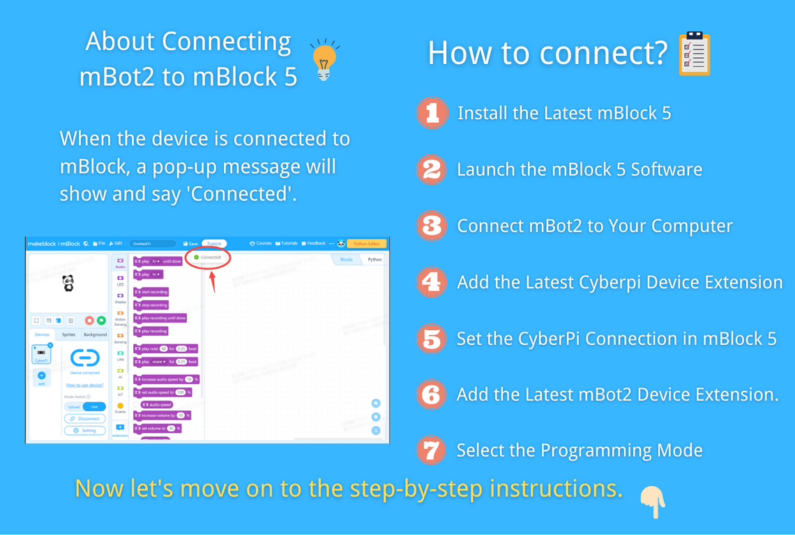

Step by Step

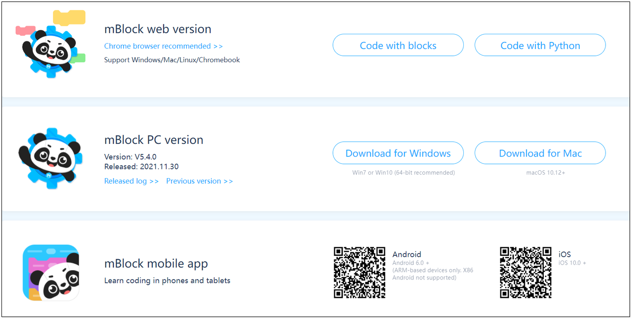

#1 Install the Latest mBlock 5
  1. Go to the official download webpage and get the latest mBlock software.
  2. Download the platform version that suits your device and preference.

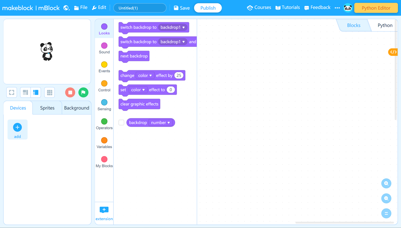

#2 Launch the mBlock 5 Software
You will see this home screen.
Note: For some cloud-based features, you'll need to log in to your mBlock account.

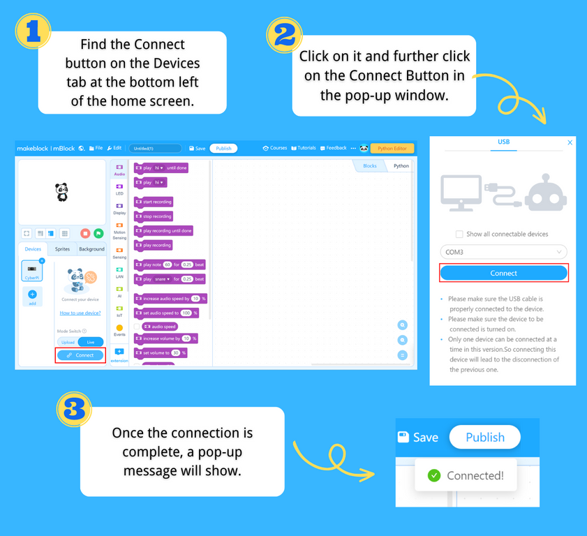

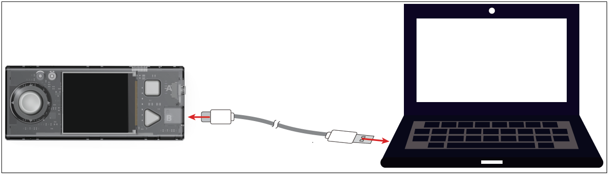

#3 Connect mBot2 to Your Computer
You can either connect by a USB-C Cable or by the Bluetooth Adaptor.
For USB connection:
复用图-USB
For Bluetooth connection:
For details, please see this guide:
https://support.makeblock.com/hc/en-us/articles/15848917011863
#4 Add the Latest Cyberpi Device Extension
#5 Set the CyberPi Connection in mBlock 5

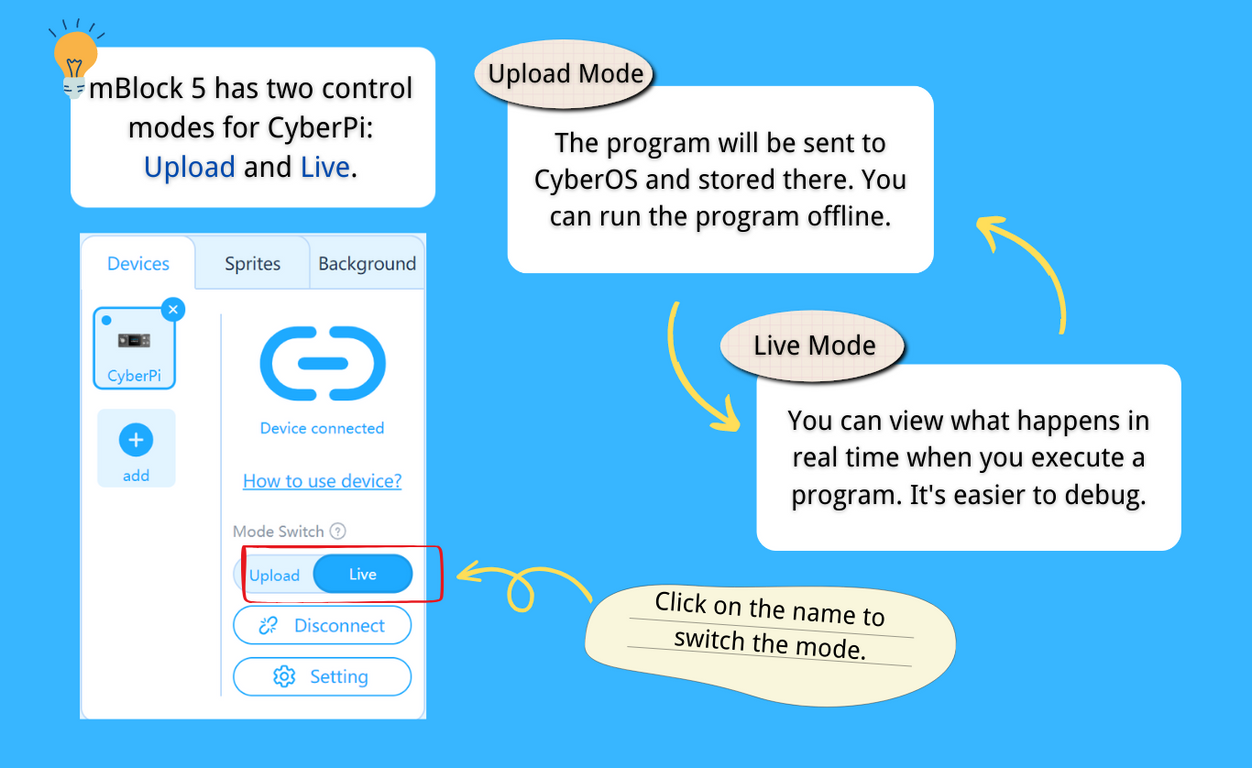

#6 Select the Programming Mode
