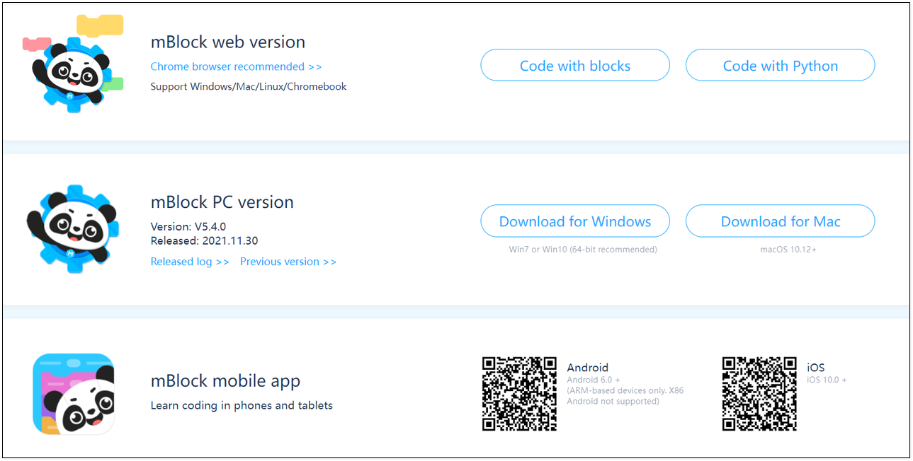

#1 Install the Latest mBlock 5
Go to the official download webpage and get the latest mBlock software.
Choose the platform version that suits your device and preference.

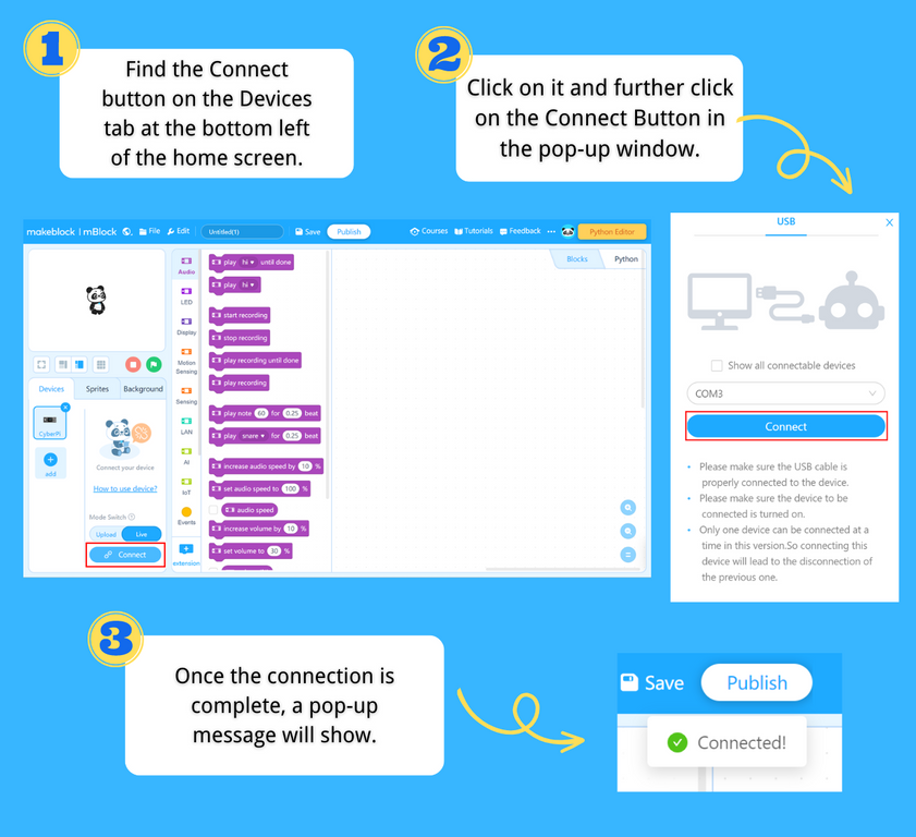

#3 Connect mBot2 to Your Computer
You can either connect by a USB-C Cable or by the Bluetooth Adaptor.
For USB connection:
复用图-USB
For Bluetooth connection:
For details, please see this guide:
https://support.makeblock.com/hc/en-us/articles/15848917011863

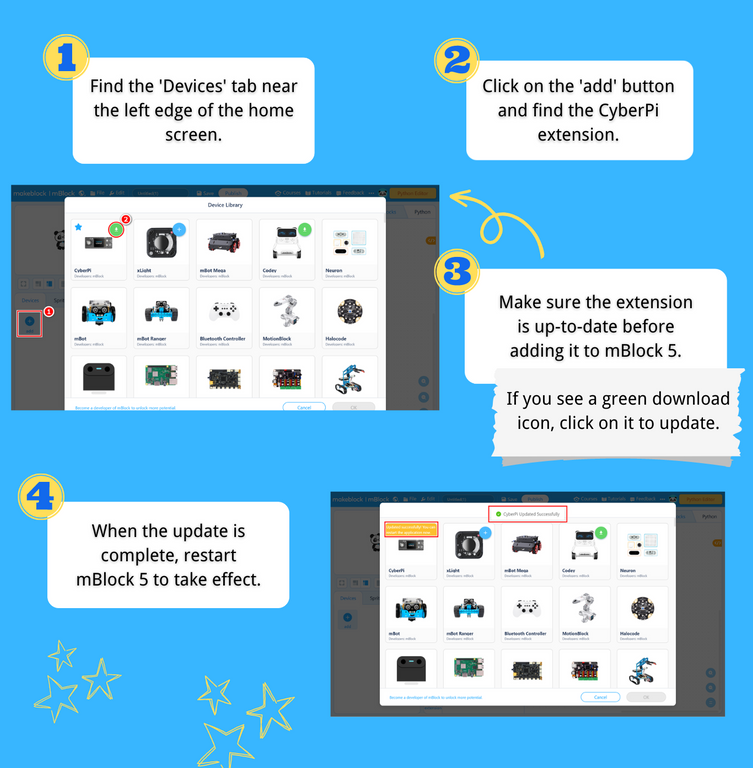

#4 Add the Latest Cyberpi Device Extension
#5 Set the CyberPi Connection in mBlock 5
复用图-连接

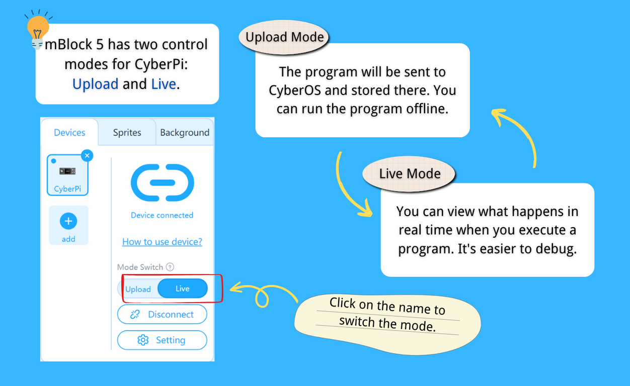

#6 Select the Programming Mode
复用图-在
