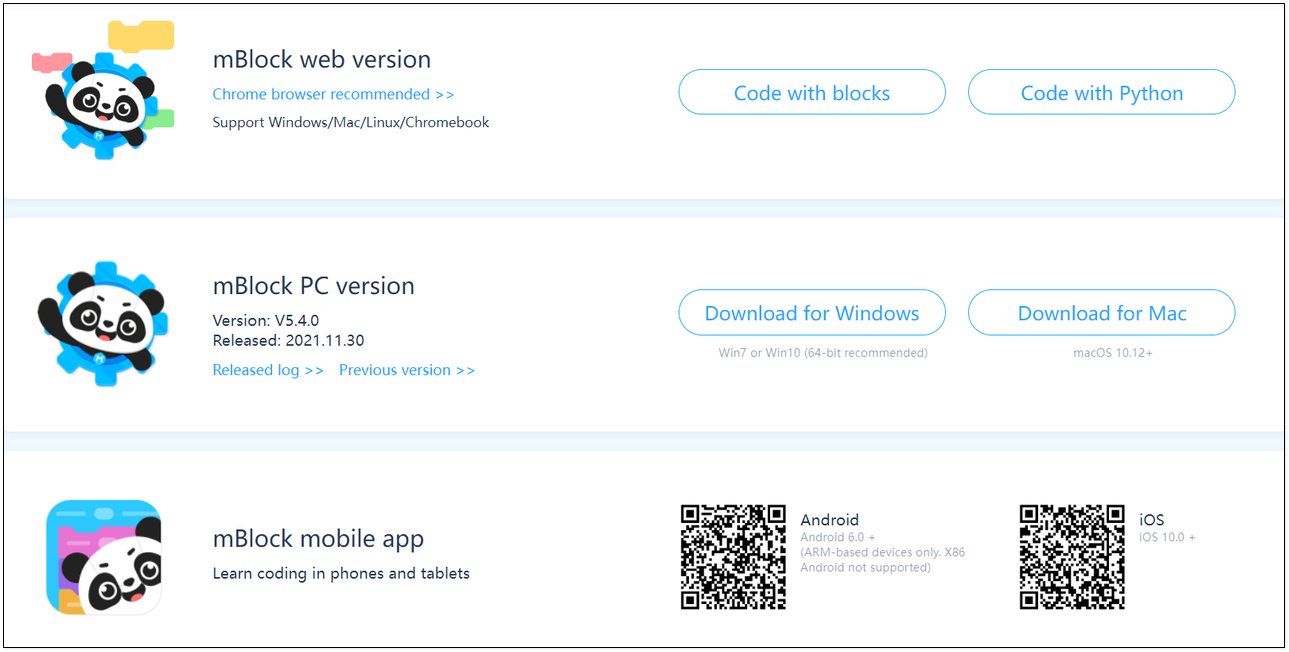

#1 Download and install the Latest mBlock 5
If the firmware is up-to-date, please move on to step #2.
  1. Go to the official download webpage and get the latest mBlock 5 software.
  2. Download the platform version that suits your device and preference.

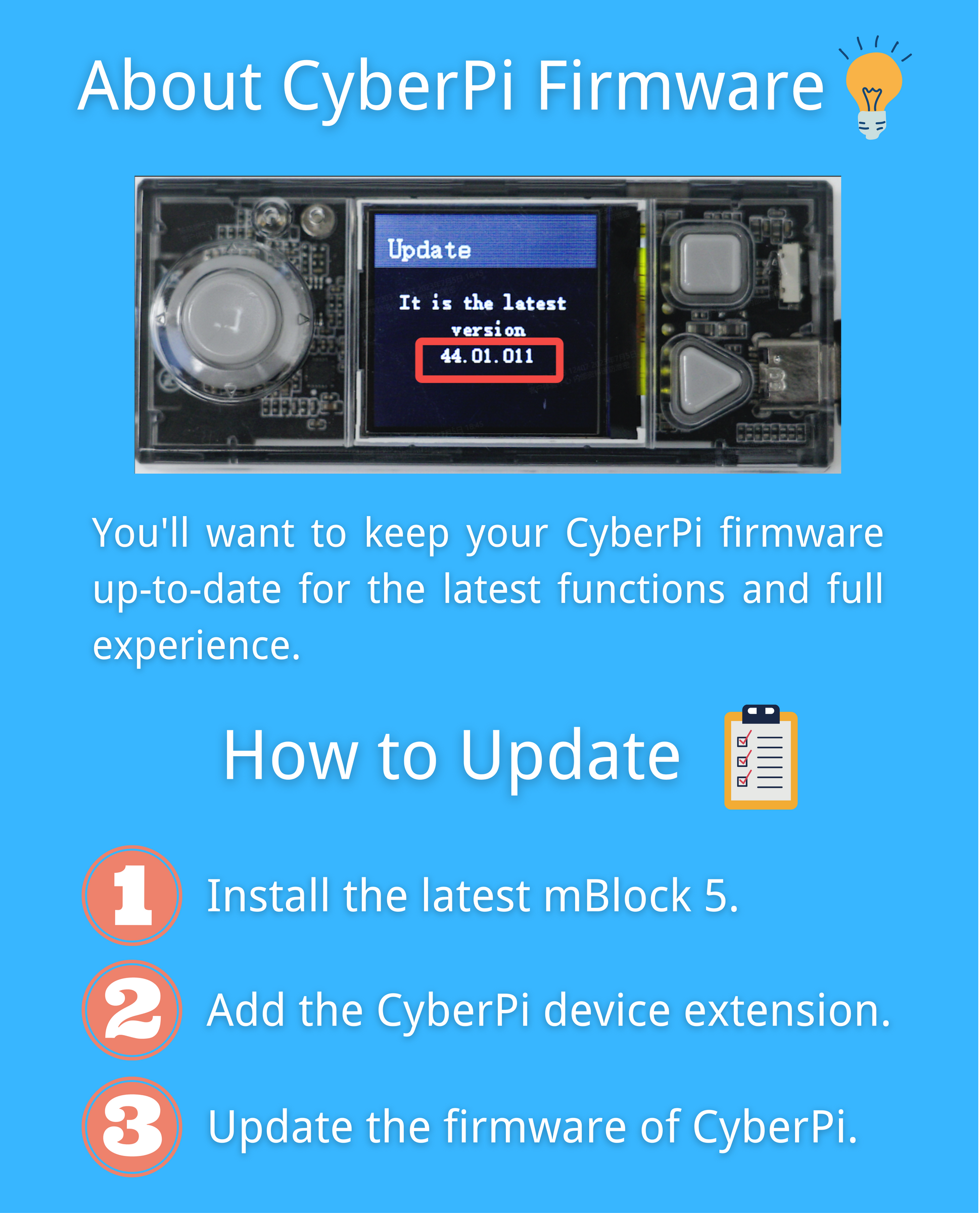

#2 Add the Latest CyberPi
#3 Update the firmware of CyberPi

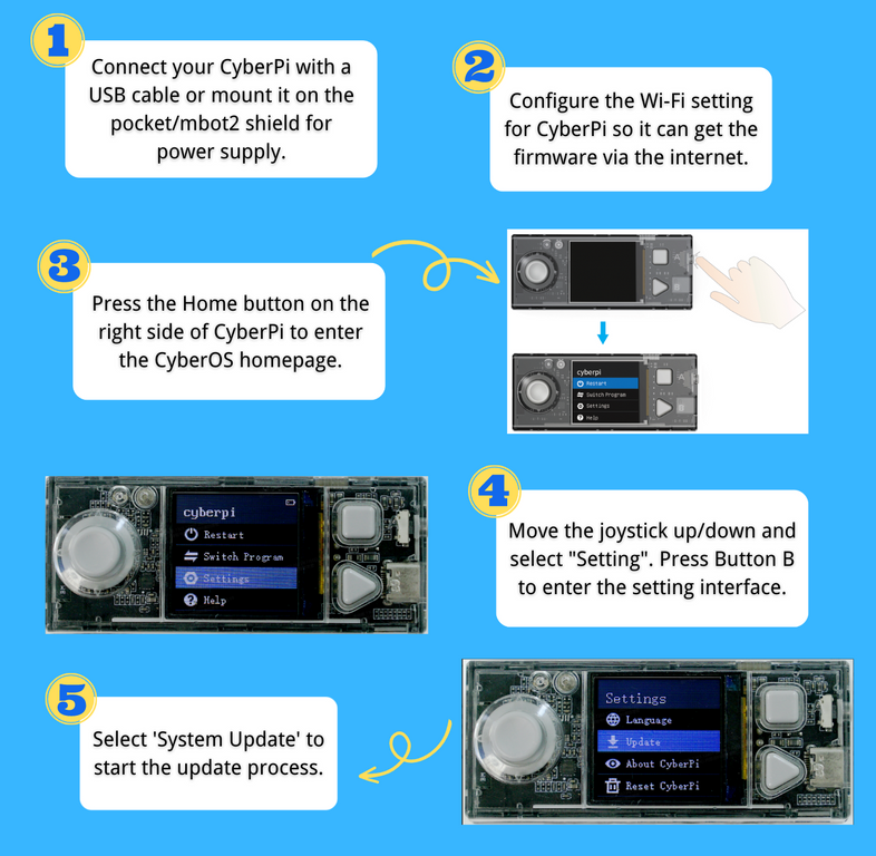

B. Update by CyberPi
Not sure how to configure the Wi-Fi mentioned above? See below:
For details, please see this guide:
