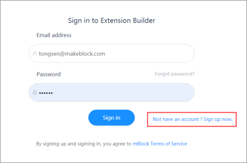

Step 1: Sign in to Extension Builder
Visit https://ext.mblock.cc.
Note:
If you don't have an Extension Builder account, you can simply sign up one. The account can be used in all Makeblock product systems, including the mBlock community, mBlock 5 on mobile terminals, mBlock 5 on PCs, and mBlock 5 webpages. With the account, you can synchronize your projects and use the AI services of mBlock 5.

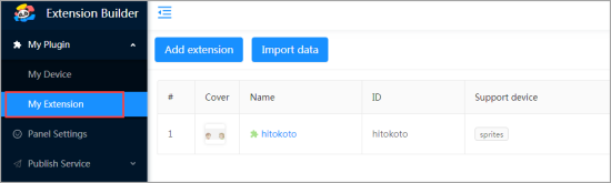

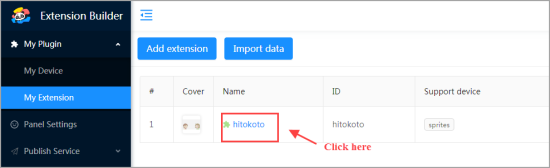

Step 2: Create an extension
After signing in to Extension Builder, choose My Plugin > My Extension in the navigation tree on the left side.
Note:
On Extension Builder, My Device refer to specific hardware devices, distinguished from sprites; and My Extension refer to extensions that must be used in combination with hardware devices or sprite.
In this development example, click Add extension, instead of Add device, to create an enhaced extension for sprites.

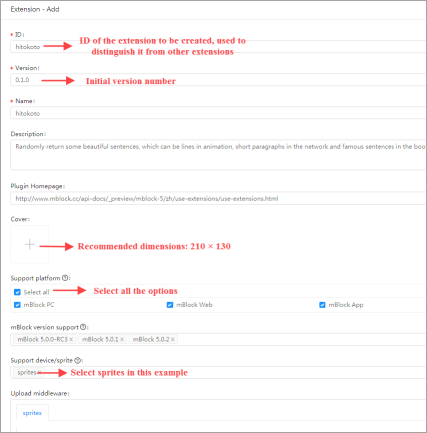

Step 3: Enter basic information
After enterng the basic information, click OK.
The extension list is displayed, and you can click the extension name to enter the editing page.

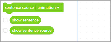

Step 5: Design blocks

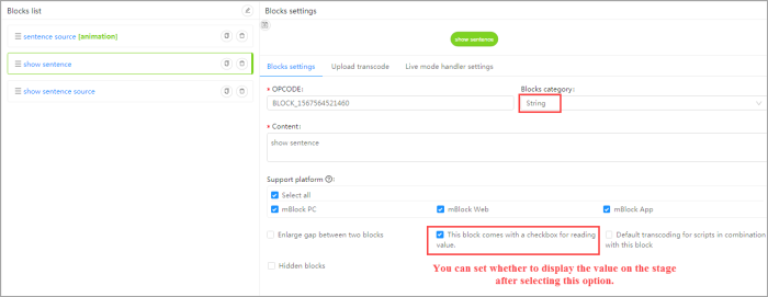

As shown in the preceding figure, we need three blocks, where the sentence source block is used to initiate an HTTP request, the show sentence and show sentence source blocks are used to display the result of the request.

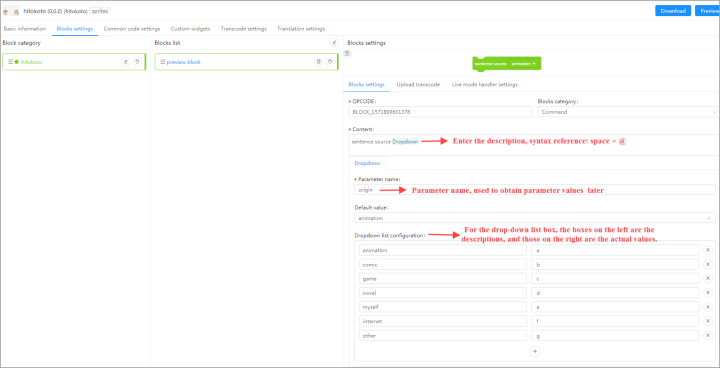

(1) Design the sentence source block.
Refer to https://v1.hitokoto.cn/?c=a&encode=json. The parameter can be set to one of the following: animation, comic, game, novel, Myself, Internet, or other.
Click + at the bottom of Blocks list to add a block.

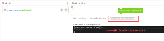

Step 6: Complete the live mode handler settings and common code·· settings
Live mode handler settings

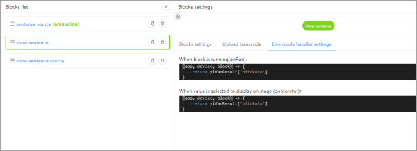

After defining the description and parameter, we can define the specific action of the block. Click the Live mode handler settings tab, the following area is displayed. Double-click the black box to enter the specific execution program of the block.
Extension Builder has encapsulated the execution interface, and so we need only to enter the corresponding js execution code in the braces. Extension Builder supports the es6 and es7 syntaxes. We can use async or other syntax.
async (args, app, device, block) => {
    const { origin } = args;  // args.origin indicating to obtain the value of the drop-down list box
    await getYiYanOfCategory(origin);

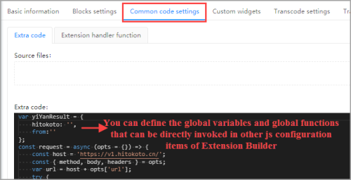

We can see the function getYiYanOfCategory. Where does it come from? The following describes a useful configuration item Common code settings.
Click the Common code settings tab, as shown in the following figure.
Double-click to edit the code. You can define the global variables and global functions that can be directly invoked in other js configuration items of Extension Builder. The getYiYanOfCategory function we see in Live mode handler settings is defined in this area. The complete code is shown in the following:
var yiYanResult = {
    hitokoto: '',
    from:''
const request = async (opts = {}) => {
    const host = 'https://v1.hitokoto.cn/';
    const { method, body, headers } = opts;
    var url = host + opts['url'];
    try {
        if (!navigator.onLine) {
            console.log('Poor network~~~~')
        let req = {
            // POST request by default
            method: method ? method : 'POST',
            headers: new Headers(),
        // Add the request parameter in body if POST request
        if (method == 'POST') {
            Object.assign({}, req, { body: JSON.stringify(body) })
        const res = await fetch(url, req);
        return res.json()
    } catch (err) {
        console.log(err.toString())
const getYiYanOfCategory = async (category) => {
    return await request({
        url: `?/c=${category}&encode=json`,
        method: 'GET'
Step 7: Define the result return blocks
Based on step 6, we can use yiYanResult to store the content obtained by the API and return the content in blocks.
Configure the blocks.
The code is as follows. The execution of the block is to return a value.
(app, device, block) => {
    return yiYanResult['hitokoto']

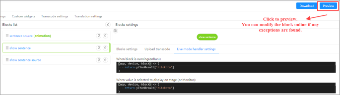

Test and commissioning

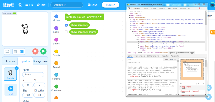

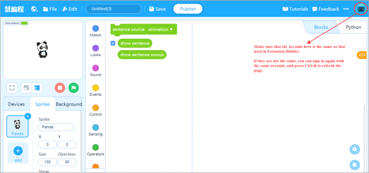

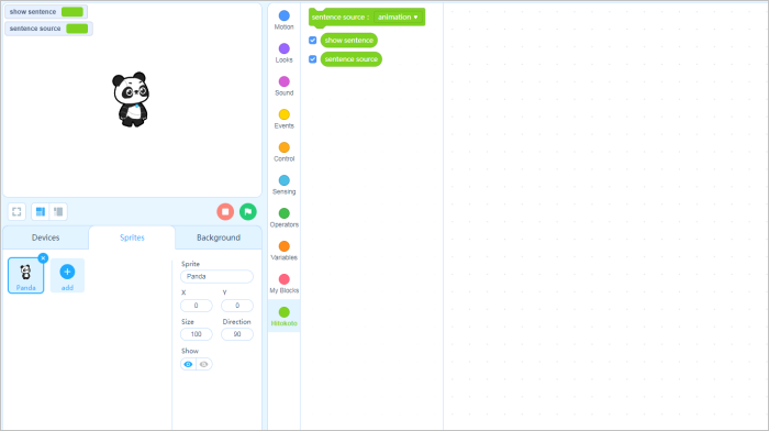

Way 1: Click "Preview" in the upper right corner of Extension Builder
A preview window is displayed. We can see the extension we created. If no extension appears, check whether the account used to sign in mBlock 5 is the same as that used in Extension Builder.
You can also right-click the title bar and choose to check your code as in a common browser.
