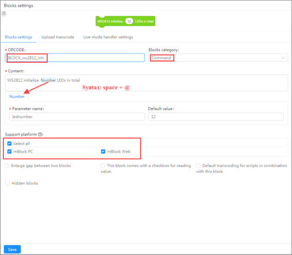

Step 4: Design the Statement Block (second minute)
(1) Click the Blocks settings tab.
(2) Click + at the bottom of the Blocks list area to add a block, and set it in the Blocks settings area on the right.
Tips:
For details about block settings, see "Configure a block."
For details about block category, see "Block Design Standards."
Refer to the official blocks when designing blocks, so that other users can easily understand how to use the your blocks.
You can add all the blocks you need, and then set the code for them.

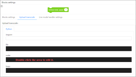

Step 5: Fill in transcode (third minute)
(1) Click the Upload transcode tab in the Blocks settings area.
Let's start with the following block.
(2) Click the Upload transcode tab.
You do not need to set the import, lib, and loop items.
(3) Double-click the code area to edit it.
(4) Enter the following code and click OK.
Tips:
The following figure shows the mapping between Upload transcode and Python in mBlock 5. The reference variable syntax is {lednumber}.
The following figure shows the mapping between Upload transcode and Python statements on mBlock 5. The reference variable syntax is {lednumber}.
The loop item is not set in this example.
This is the third minute, and the extension has been created.

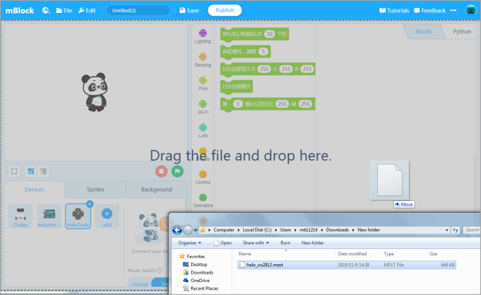

Step 1: Download the extension and drag it to mBlock 5 on your PC

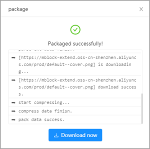

1. Click Download in the upper right corner.
The package box is displayed.
2. Wait for the packaging to complete, and click Download now.
3. Open mBlock 5, find the halo_ws2812.mext file, and drag it to mBlock 5.
The installation is successful if the message indicating that WS2812 is successfully updated is displayed.

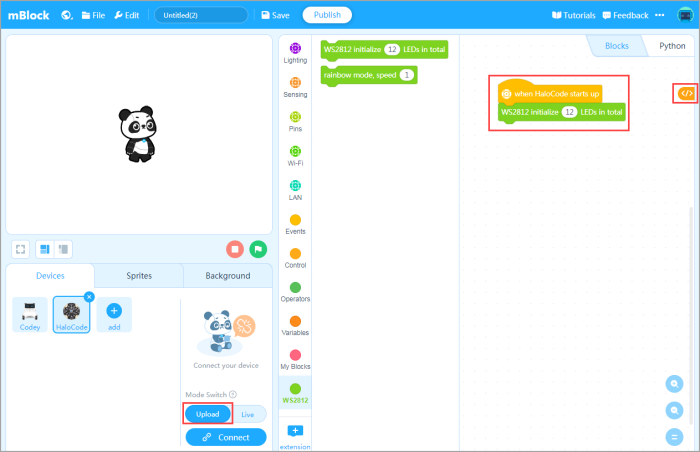

Step 2: Test the blocks
Drag and drop blocks to the Scripts area.
Before dragdging the blocks, you need to:

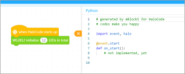

(1) Set the mode to Upload, and drag an Events block to the Scripts area first.
(2) Click the </> Button at the right sidebar to display the code interface.
Check the code generated by the blocks carefully.
Tips:
You can copy the code and paste it to the Python editing interface. Upload the program to Halocode, and if there is any error, you can see the error information returned by Halocode.

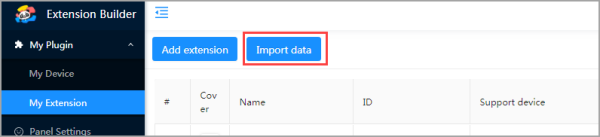

Another way to learn extension block sesign
In addition to the step-by-step learning by following the tutorial, you can also find an extension, import it to the extension builder, and refer to it.
What you need is to import it to the extension builder.
After importing an extension, you can see in detail how it is designed.
For details about how to import an extension, see "Importing an Extension into Extension Builder."
