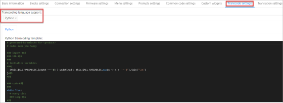

Modify the transcoding template
When configuring an extension or device extension, click Transcode settings, set Transcoding language support to Python, and modify Python transcoding template.
Place the add function on top of ### code #$$, as shown in the following:
# generated by mBlock5 for <product>
# codes make you happy
### import #$$
### lib #$$
# initialize variables
(this.$ALL_VARIABLES.length === 0) ? undefined : this.$ALL_VARIABLES.map(n => n + ' = 0').join('\\n')
def add(a, b):
print('%d+%d=%d'%(a,b,a+b))
### code #$$
while True:
# every tick
### loop #$$
Advantage: You can see the transcoding in real time when putting blocks together.
Disadvantage: If two much common code is added, the transcoding template may not be easy to read, and thus may be difficult to maintain.

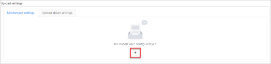

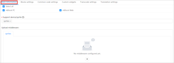

Define common code in middleware
When configuring an extension, click Basic information and configure the common code in middleware.

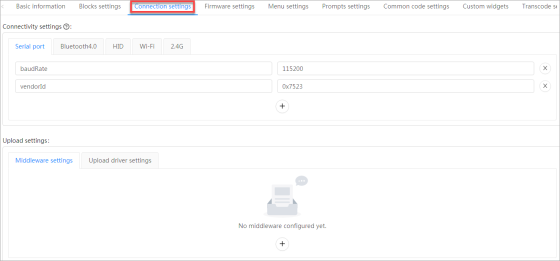

When configuring a device extension, click Connection settings and configure the common code in middleware.

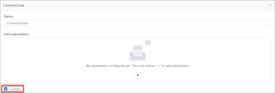

The following describes how to configure middleware for a device extension:
1. Click + to add middleware.

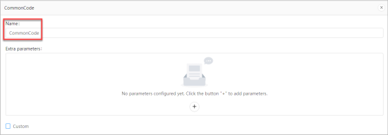

2. Set the name of the middleware.
3. Check Custom.

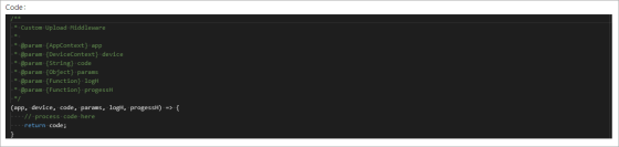

4. Edit the code.
The code shown in the preceding is the strings into which the blocks are translated. You can insert the common code required into the code and then return the code, as shown in the following:
* Custom Upload Middleware
* @param {AppContext} app
* @param {DeviceContext} device
* @param {String} code
* @param {Object} params
* @param {Function} logH
* @param {Function} progessH
(app, device, code, params, logH, progessH) => {
// process code here
code += 'def add(a,b):
print('%d+%d=%d'%(a,b,a+b))\n';
return code;
Advantage: You can write any code that you don't want others to see in the middleware.
Disadvantage: Transcoding can't be seen in the transcoding area in real time. You can see the transcoding only after clicking Upload to upload a program to a device.
