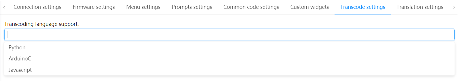

Set the transcoding language
Use Python as an example. After setting the transcoding language to Python, you need to configure the transcoding template.

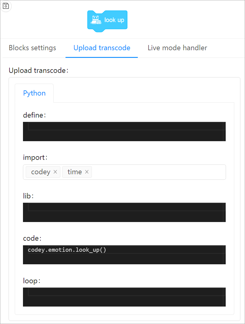

Corresponding to Upload transcode setting of each block
If multiple blocks are configured with the same field, the multiple values of the field are combined as follows:
import = the import field of block A + the import field of block B + ...
This is processed by the the code generator. Generally, you can use the default settings of the generator; however, if it doesn't work as expected, you can modify the settings in the generator on the Transcode settings tab.

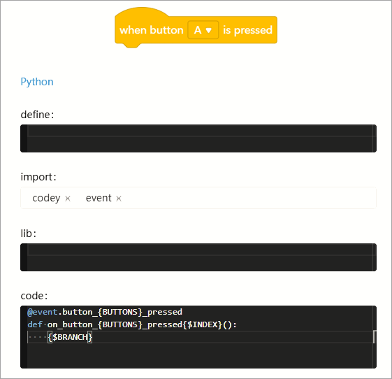

Block template
Used to generate the code of a block, for example, when button () pressed for Codey.
@event.button_{BUTTONS}_pressed
def on_button_{BUTTONS}_pressed{$INDEX}():
    {$BRANCH}
In the preceding statements, BUTTONS is a parameter configured for the block and {BUTTONS} is replaced with the actual value when the statements are executed.
