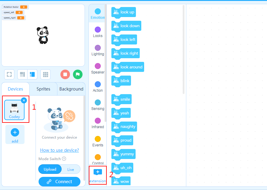

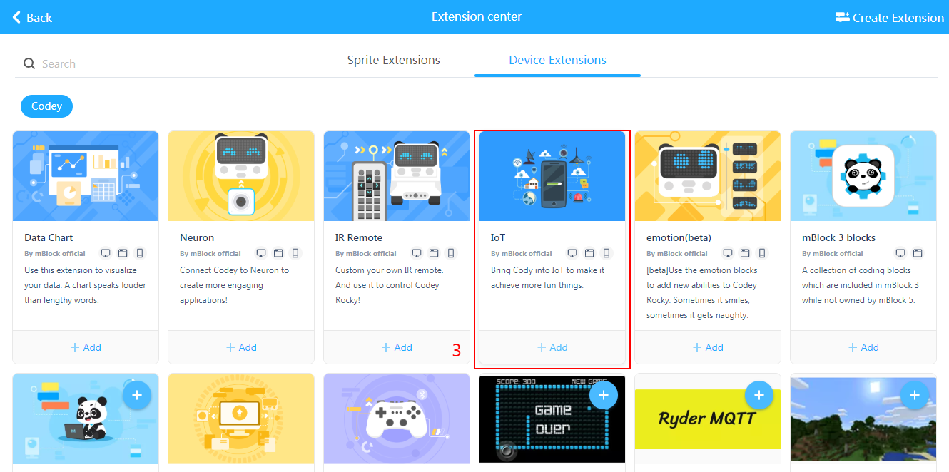

16. Where can I find the IoT extensions?
Select the device "Codey" at the bottom of stage, in the block selection area, click "+", select extensions and you can find the IoT module inside.
