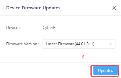

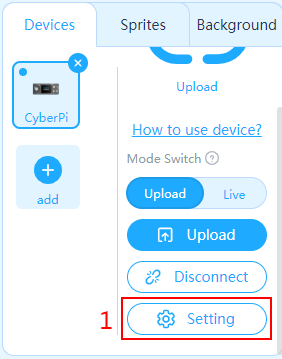

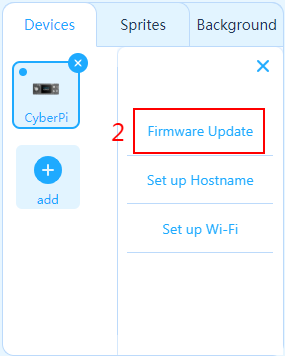

Step 4: Click Setting, and then click Firmware Update
4cfdfe36-ae6a-4208-83e9-13cb0368a436.png7224b775-86d3-4376-9f96-0a8dd3bb7dff.png2038bcfb-5aa3-4c6d-97d7-8415837c0767.png77cffd40-8db0-4e8f-9639-4fb73bf83c7b.png

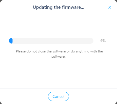

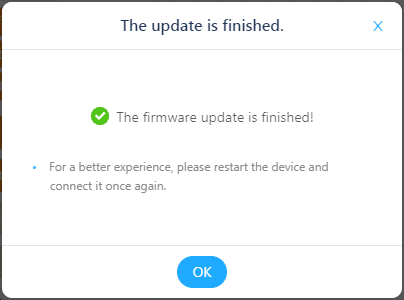

Step 5: Wait for the firmware update to complete (it takes about 3–5 mins), replug the USB cable, and check if the screen lights up properly.
c3166bfe-1c76-40e0-a740-9da4cd0c677d.png2038bcfb-5aa3-4c6d-97d7-8415837c0767.png07a9e78d-1720-4c32-b94d-f0aab128ed10.png
Note: Do not unplug the USB cable or power off CyberPi during the process to prevent the risk of hardware failure.
