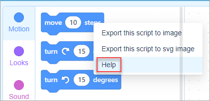

As shown in the following figure, the area in the red box is the Blocks area where multiple categories of blocks are provided for programming.
For details about how to use each block, right-click a block and choose Help.
