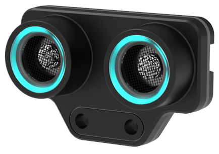

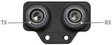

The ultrasonic sensor 2 can be used to detect the distance between an obstacle and it. The transmitter on the left transmits ultrasonic waves, and the receiver on the right receives the ultrasonic waves reflected.
Compared to the ultrasonic sensor we've developed before, the ultrasonic sensor 2 is improved in its casing, chip, and blue LEDs. The blue LEDs can increase the potential for emotional expression and interaction.

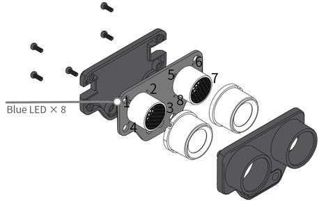

The ultrasonic sensor 2 is equipped with eight blue LEDs. Through programming their brightness, you can use the ultrasonic sensor 2 to express various types of emotions and information.
Example 1:
After you press button A, the ultrasonic sensor 2 expresses the emotion of happiness by "smiling" when you shake it.
Note: In this example, "smiling" is performed by lighting up the blue LEDs in positions 1, 2, 5, and 6 and turning off those in positions 3, 4, 7, and 8.

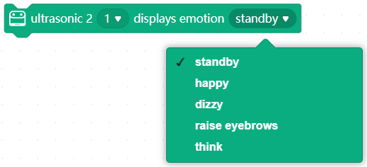

Alternatively, you can use the emotion block provided on mBlock 5 to express an emotion:

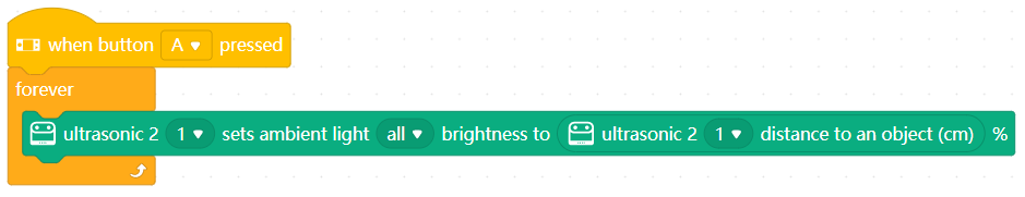

Example 2:
After you press button A, place an obstacle close to the ultrasonic sensor 2, and then move the obstacle slowly away from it.
You can see that the blue LEDs become brighter as you move the obstacle. A higher brightness indicates a larger distance.
